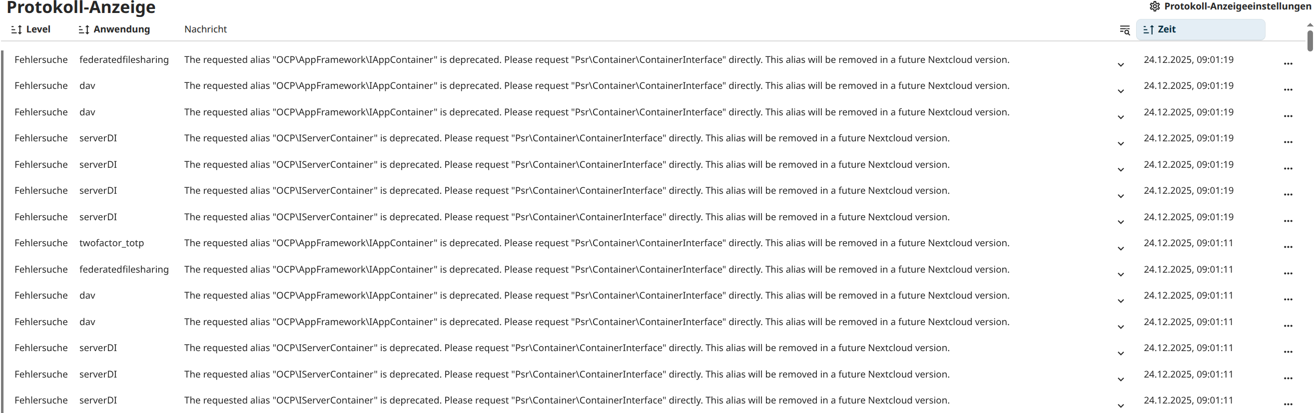

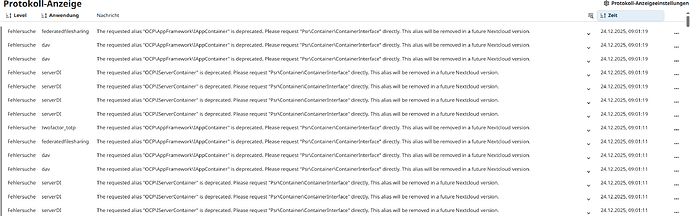

A lot of entries in log of type deprecated
I use nextcloud 32.0.3 on my vserver with PHP 8.3.28. In the log files I get a lot of deprecated entries and nextcloud.log is very hughe.
How can I disable the deprecated log entries?
Thank you for your help.
BR
Martin
Just don’t set the loglevel to 0 / debug. It’s not recommended anyway and hurts performance
