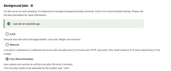

Edit 2:
I was getting some errors and cron stopped working.
I did a fresh install again.
This time I didn’t configure redis unixsocket/unixsocketperm. Only installed redis.
