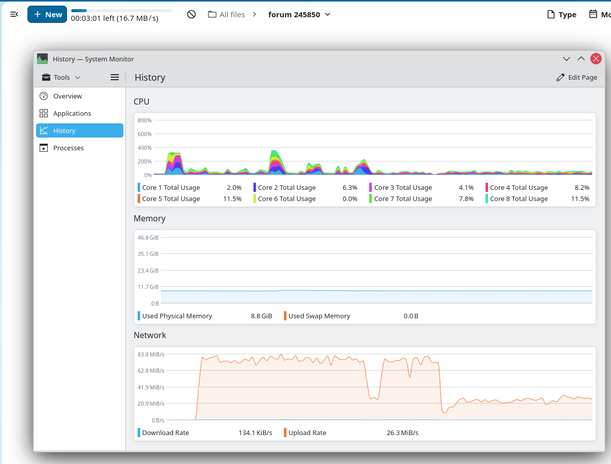

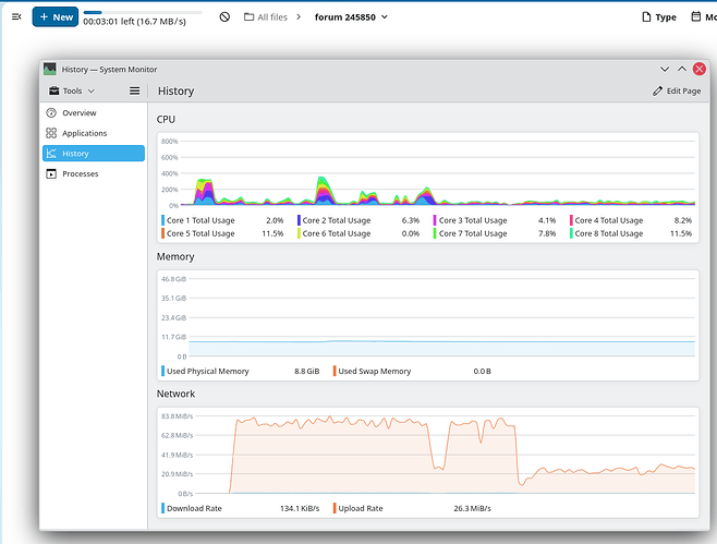

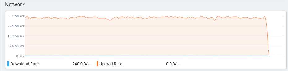

I’m uploading test files (1GB, 5GB) from an AWS Windows client in the USA (Oregon) to a Nextcloud AIO instance in Europe (Helsinki), RTT ~185 ms, with no packet loss. I’m hitting two related problems which cause a drastically reduces upload speed:

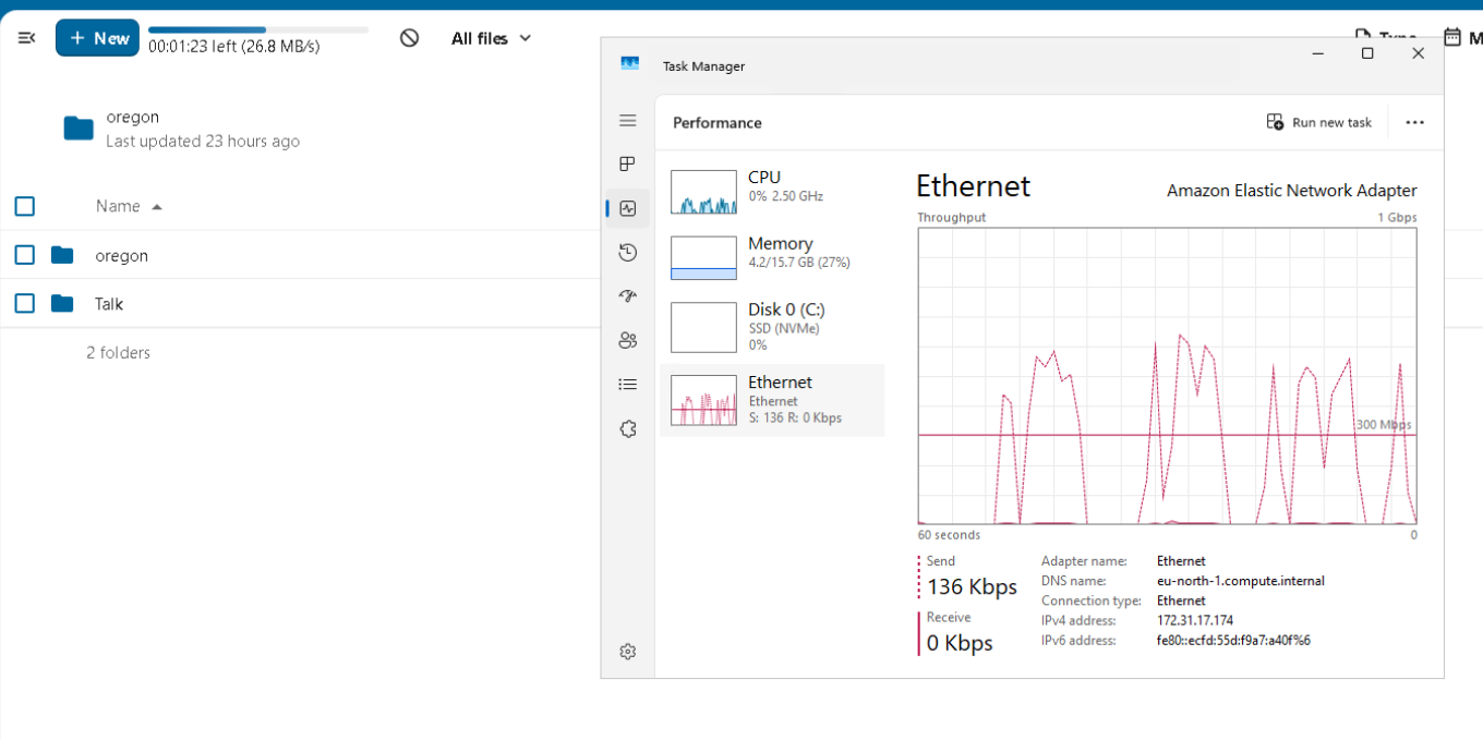

Issue 1: Bandwidth idles between chunk batches.
The web UI uploads in batches of 5 parallel chunks (100 MB each). In the browser Developer Tools Network tab, all 5 chunks start together and finish together, then there’s a short wait (~8 seconds) for the 200 responses from Nextcloud before the next batch begins. For some reason, it takes Nextcloud quite long (8 seconds) to respond with 200. During 8 seconds the bandwidth goes to idle. Staggering the chunk starts would be amazing to keep bandwidth fully utilized. When uploading 5 GB, the chunks get out of sync eventually and causes the next chunks to start at individual times, which reduces or sometimes eliminates the 8 seconds entirely.

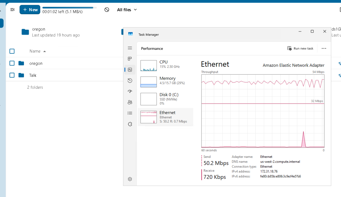

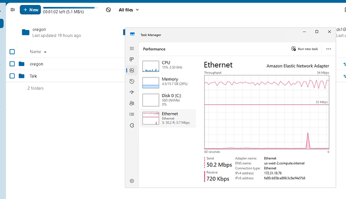

Issue 2: Transatlantic upload speed is capped at 5 MB/s.
Uploads tops at roughly 5 MB/s from the client in Oregon. A AWS client in Stockholm is uploading at 25 MB/s. Sure, long distance causes latency. But concurrent upload streams should eventually almost reach the same speed as closer clients, right?

  4. Observe: chunks upload in batches of 5, start and finish in lockstep.
  5. Aggregate throughput tops out around ~50 Mbit/s. Measured in Task Manager or htop/btop on server side. Showing 5 MB/s in web-ui.

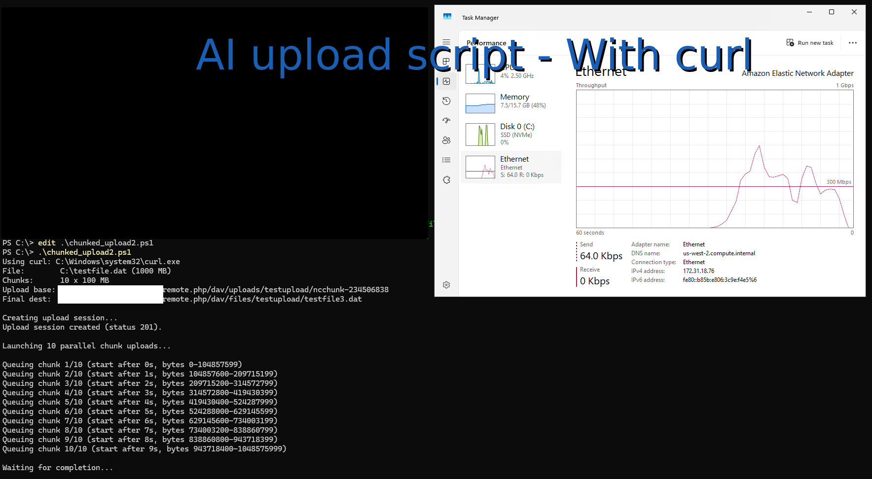

    AI script: Tested using curl and a staggering chunk start in a script. It reached 50 MB/s from the same client. Assembling the file takes very long too, but probably another issue.
  • files max_chunk_size change via occ had no effect on web UI chunk size (stayed 100 MB).
  • Speed test with iperf3: 87 MB/s upload to Nextcloud from Oregon (long distance). 500 MB/s download to Oregon client. The general connection between them does not seem to be the problem.
  • Tested from a closer location as well. Which was much faster, but still had small bandwidth idle gaps of 5-8 seconds between chunk batches.
  • Just as a comparison: Dropbox uploads are running with 75 MB/s continuously. I know, it’s not fair to compare, but my users are comparing it this way.

docker logs -f nextcloud-aio-caddy:
No messages during upload.
iperf3
Network speed test from Helsinki to Oregon. Server to client.
Summary
PS C:\> .\iperf3.exe -c xxxxx -p 5201 -t 10
Connecting to host xxxxx, port 5201
[  5] local 172.31.18.76 port 58807 connected to xxxxx port 5201
[ ID] Interval           Transfer     Bitrate
[  5]   0.00-1.00   sec   384 KBytes  3.14 Mbits/sec
[  5]   1.00-2.00   sec  3.75 MBytes  31.5 Mbits/sec
[  5]   2.00-3.00   sec  9.00 MBytes  75.5 Mbits/sec
[  5]   3.00-4.00   sec  19.1 MBytes   160 Mbits/sec
[  5]   4.00-5.00   sec  67.4 MBytes   565 Mbits/sec
[  5]   5.00-6.00   sec   130 MBytes  1.09 Gbits/sec
[  5]   6.00-7.00   sec   282 MBytes  2.37 Gbits/sec
[  5]   7.00-8.00   sec   390 MBytes  3.27 Gbits/sec
[  5]   8.00-9.00   sec   566 MBytes  4.75 Gbits/sec
[  5]   9.00-10.00  sec   573 MBytes  4.81 Gbits/sec
[  5]   0.00-10.00  sec  1.99 GBytes  1.71 Gbits/sec                  sender
[  5]   0.00-10.18  sec  1.97 GBytes  1.66 Gbits/sec                  receiver
iperf Done.
PS C:\> .\iperf3.exe -c xxxxx -p 5201 -t 10 -R
Connecting to host xxxxxx, port 5201
Reverse mode, remote host xxxxxxx is sending
[  5] local 172.31.18.76 port 53159 connected to xxxxxx port 5201
[  5]   0.00-1.00   sec   256 KBytes  2.10 Mbits/sec
[  5]   1.00-2.00   sec  8.75 MBytes  73.4 Mbits/sec
[  5]   2.00-3.00   sec  75.4 MBytes   633 Mbits/sec
[  5]   3.00-4.00   sec  85.1 MBytes   714 Mbits/sec
[  5]   4.00-5.00   sec  87.6 MBytes   735 Mbits/sec
[  5]   5.00-6.00   sec  87.1 MBytes   731 Mbits/sec
[  5]   6.00-7.00   sec  87.6 MBytes   735 Mbits/sec
[  5]   7.00-8.00   sec  88.2 MBytes   740 Mbits/sec
[  5]   8.00-9.00   sec  86.4 MBytes   725 Mbits/sec
[  5]   9.00-10.00  sec  88.6 MBytes   743 Mbits/sec
[ ID] Interval           Transfer     Bitrate         Retr
[  5]   0.00-10.18  sec   804 MBytes   663 Mbits/sec    0            sender
[  5]   0.00-10.00  sec   695 MBytes   583 Mbits/sec                  receiver
iperf Done.

Once thing I just cant really wrap my head around, is how Nextcloud/desktop client have 5 MB/s upload, while a 20 minutes AI developed script doing the same upload and using the same WebDAV reaches 50 MB/s. The only thing the AI script did differently was staggering the chunk starts 1 second apart. Staggering the chunks should only fill the idle gap, but still wouldn’t lift the general upload speed.
Upload from long distance with web-ui:
Upload from same windows client, long distance, with staggering curl script:
Also iperf3 measured 85 MB/s. But sure, there is no data handling involved, not fair to compare.
Also: Upload speed is faster when closer to the server, but it also is very fluctuating. It still doesn’t look very optimized. I guess the issue just grows with distance.
AI script upload with curl reaching up to 600 Mbps

UPDATE: it’s even more weird.. testing WEB upload using 6x600MB files I see following strange behaviour
  • i planned to verify your chunk theory: but I see no drop between chunks
  • transfer started at 80MB/s and dropped to 30 MB/s later (FIrefox)
  • another try (Chromium) started at ~30MB/s and stayed constant (with 1.2 drops to 20MB/s))
at the end - Nextcloud itself is capable to consume more than 5MB/s..
