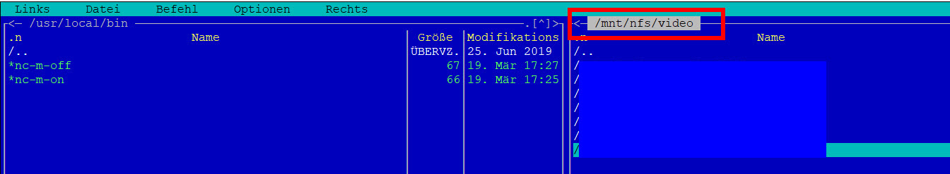

I am now using the Midnight Commander, I can handle it. I also have a connection to my NFS share. I can use it to copy files.
