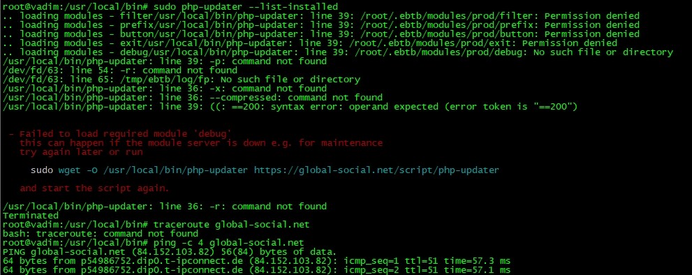

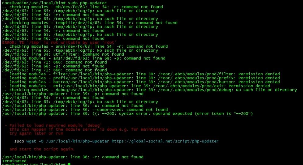

Thanks. Yes, internet access and DNS working fine. I know when I ran the initial wget command though from the Ubuntu host nothing downloaded - I just ended up with a zero byte file. I opened https://global-social.net/script/php-updater in Chrome manually and the script appeared inline immediately, so I copy/pasted that into the file in Linux. Didn’t think anything of it really, but when I run it with sudo, it just fails on loading the modules every time.
Is it actually pulling the modules down from global-social.net, or from a general internet repo?
But that chrome-browser is not on the same host as your server, right?
It still looks like you have no access to the server from your linux host.
You can test the connection with these commands, which you should run on your linux server:
ping -c 4 global-social.net
nc -zv global-social.net 443
traceroute global-social.net
(( $(curl -I -o /dev/null -s -w %{http_code} https://global-social.net/status.php) == 200 )) && echo "connected" || echo "not connected"
You can send me the output per PM if you want
global-social.net is the module server
h.t.h.
Much and good luck,
ernolf

Hi @ernolf
First of all thank you for this script!
Can you help me.
today I run the script and get this error.
Hi @Vadim,
The script is constantly being improved and developed.
If you had read carefully what the error output says, you would have seen that I’ve already helped you (the red colored text).
If the changes are too major, 100 percent backward compatibility can no longer be guaranteed and the integrated updater then no longer works.
So run the command displayed (which is nothing else than an update) and start the script again:
sudo wget -O /usr/local/bin/php-updater https://global-social.net/script/php-updater
sudo php-updater
The integrity check is carried out again first, so there is no security gap.
h.t.h.
Much and good luck,
ernolf
Sorry, I understand it’s annoying when users don’t read what the program writes to them, but that’s exactly what I did before contacting you.
But it didn’t work
Oh! I am so sory. :flushed:
Could you please try to remove the old modules:
sudo rm -fr /root/.ebtb
That forces the binary to download the new ones.
I hope that works.
:crossed_fingers:
ernolf

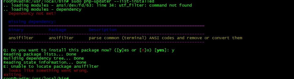

Thank you for wasting your time with me.
I did that, now another error appears
It’s a new dependency on the package ansifilter, which is normally available in the apt sources of Debian and Ubuntu:
Are you using a different distribution or a rare architecture?
But to help you and others who might stumble upon this limitation, I removed the dependency on ansifilter and wrote a function that has the functionality of Ansifilter.
ansifilter will still be used if it’s installed, but if it’s not installed, the internal function will be used.
So please remove the ~/.ebtb directory one more time and start again.
ernolf
In this thread somone got the same error with th nc-who script, and I’d say they probably on Ubuntu have the universe repo disbaled for some reason.
In Debian the ansifilter package is in main, which of course always needs to be enabled to be able to use Debian, but in Ubuntu it’s in universe, which should also be enabled by default, but who knows, maybe it’s been disabled by the user, either intentionally or unintentionally when messing with the sources.list. Or maybe there are some Ubuntu based distros out there where it’s disabled for some reason… :man_shrugging:
@Vadim If you are on Ubuntu, try the following and then run the script again:
sudo add-apt-repository universe
