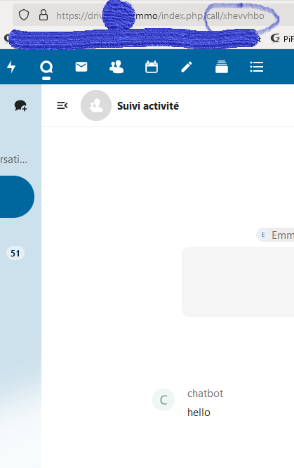

I’m trying without any success :
What could be wrong ? Where I can search helps ? any log ?
And POSTMAN :
With body playload :
{ā€œtokenā€:ā€œxhevvhboā€, ā€œmessageā€:ā€œI am hereā€}
