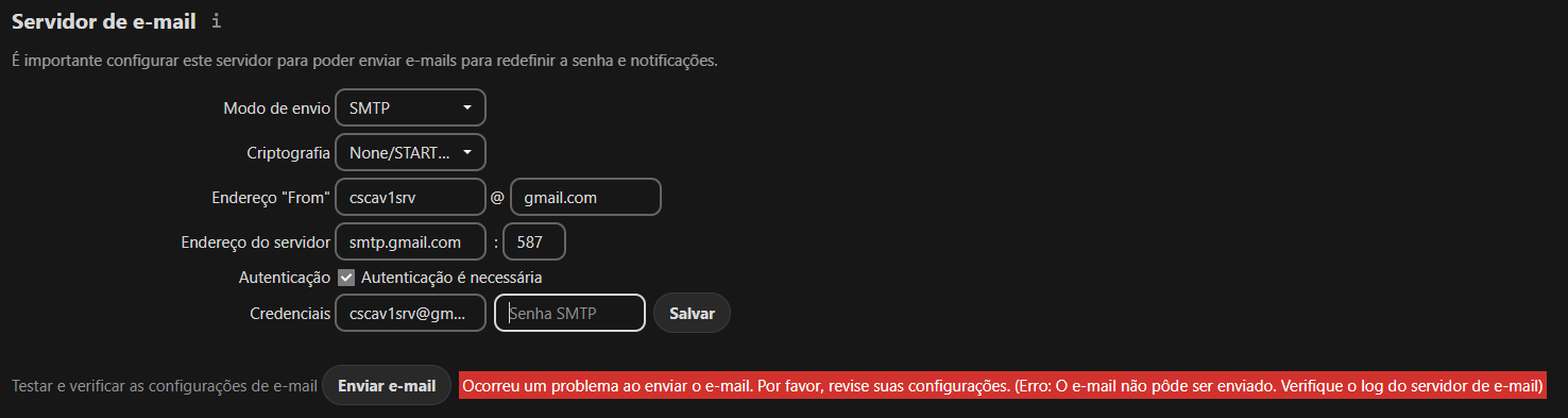

But are we scanning local ports, aren’t that?
How can it be provider side if email is working properly out of Nextcloud?
Yes they are. But you need open ports on there —> smtp.webcenter.com.br
Let’s explain all later?
So is this working:
/usr/bin/nmap -dd smtp.webcenter.com.br 587,465
and are you inside a container?
What you get from:
nslookup smtp.webcenter.com.br

Thank you, but it doesn’t work. I done what you described, but it doesn’t set a server email sender.
Any other idea?

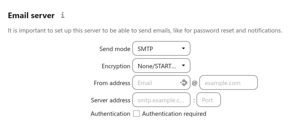

Did you update this screen? Also, you will need to enable either the Mail app or the Rainloop or the Snappy app to see the IMAP emails from the server. This is only for sending. And finally, if you want to RECEIVE emails IN the SERVER to TRIGGER an action, that’s something else altogether.
Hi, thank you… Yes, I updated the screen before and after apply the settings you recommended.
But the message Nextcloud still cannot send the test email is there.
I attached screenshots of what you said to do.

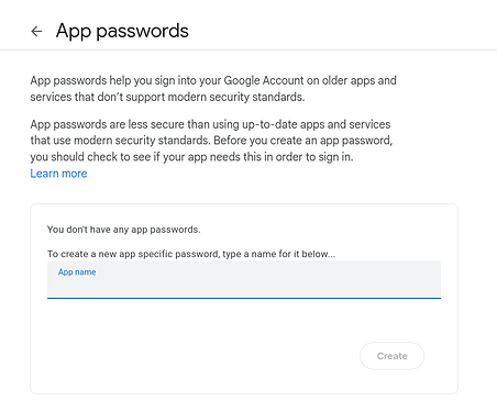

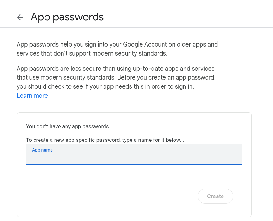

Missing one update:
https://myaccount.google.com/apppasswords
You need to create an app-password here and use that created password as your password in NextCloud. Google will give you a 16 character password (no spaces required in NextCloud - just the characters).
