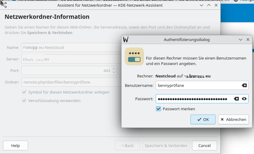

  1. To connect to the share with KDE Dolphin, I did this:

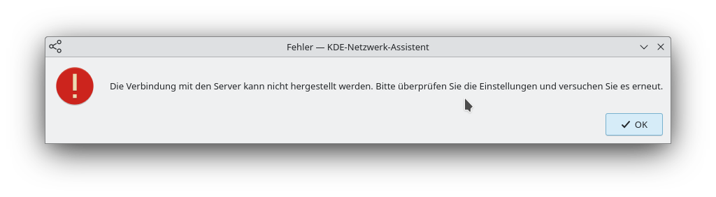

The answer then is this:
Meaning basically “Cannot connect to server. Check your settings and try again”. The reason I’m sure the settings are correct is because the server sends me a login prompt. The reason I think it rejects my password is as follows:
