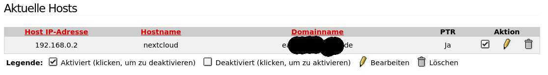

Lots of routers are also able to work as a local DNS-Server. The point is just that some folks are not aware aboiut this.
So i do not find it puzzling @hap’s Router offers that.
Here is an example what @hap most likely have done:
This isn’t an example from @hap’s router but from IPFire; however, many routers do offer similar options.
And if @hap has used a similar option, then he’s done everything correctly on his LAN. The only thing left to check is why
  • 8.8.8.8 cannot resolve the domain name and
  • why the smartphone, whilst on the LAN, isn’t using the router’s DNS server and isn’t getting the same response as the Linux desktop
