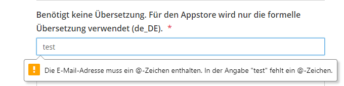

One thing I noticed: Why do I have to use a web form (Generate app - App Store - Nextcloud) to generate a skeleton app to start developing? (You can’t even select NC24 as a target). I guess it would make sense (especially after reading the comments above) to offer some kind of CLI tools to: create a skeleton app, register an in the app store, publish an app, etc.
Then suddenly there’s GitHub - ChristophWurst/krankerl: A CLI helper to manage, package and publish Nextcloud apps, which looks like it would solve some of the publishing problems mentioned above, but (much like the docker dev container) it’s quite inofficial and not mentioned in the documentation. There are a few good enhancement requests in the repo there:
Add commands for certificate management
Have a GitHub action
I guess this would be really appreciated to have.
Btw, the web form for the skeleton app is not correctly translated …
