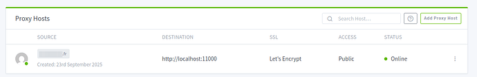

Proxy host on NPM is configured as expected I think :
So what’s the matter ? thanks for your help.
