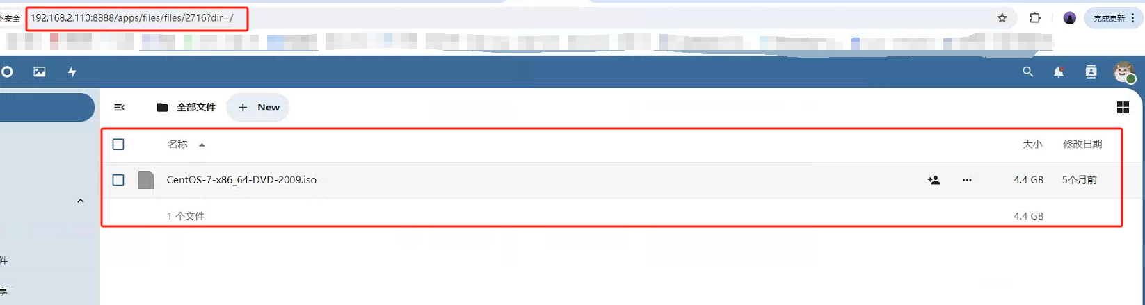

When uploading files, prompt ‘Unknown error occurred during upload’
I installed NextCloud using Docker, set the file upload size in the command, and accessed the browser page using IP+port to upload larger files. However, after using NAT to translate the address, only files below 30MB can be uploaded, otherwise an error message ‘Unknown error occurred during upload’ will be reported,after a while, I found out that IP+port access also reported errors‘Unknown error occurred during upload’ ,please help me

What does your Nextcloud log say?
This is the content of NextCloud log

Insufficient space in /, 4712300544 required, 3225899008 available
Seems the explanation.
The log path I found is in ‘/var/www/html/data/nextcloud.log’, I’m not sure if it’s this log file, and I’m not sure why sometimes larger files can be uploaded, but sometimes they can’t
