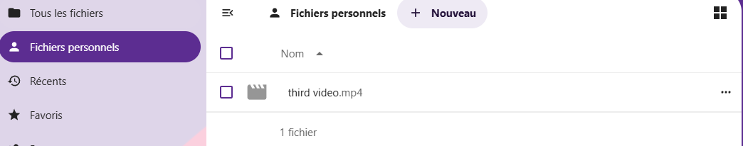

  • I tried uploading the third video to my “personal space” and it worked.

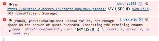

When using the console, i have those 2 errors that pops up.
So if i got that correctly, it is indeed related to either storage on the server or storage space attributed to my user id.
