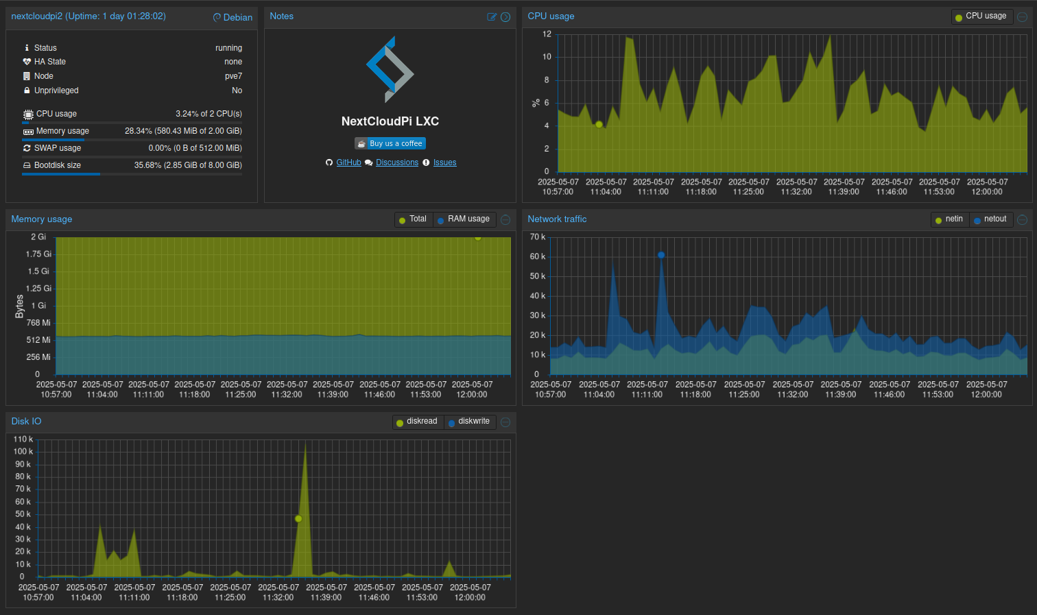

By the way, here’s the machine load graph from the last hour (basically none), while it still takes 20 seconds to load a chat via Nextcloud Talk

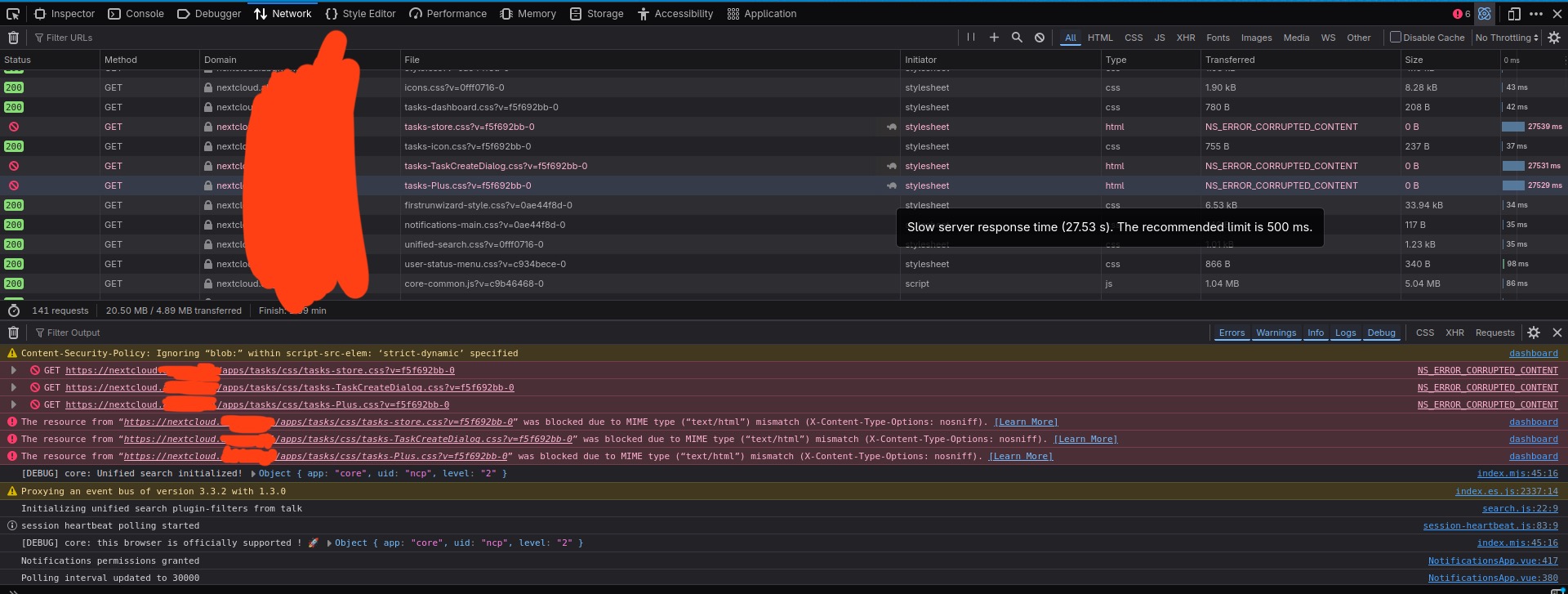

However, the server takes 25 seconds to respond and I can see some errors:

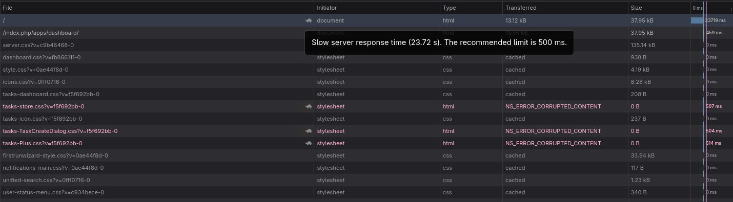

however, there’s no speed difference (image below), and sending messages via Nextcloud Talk app still takes ~10-18 seconds
