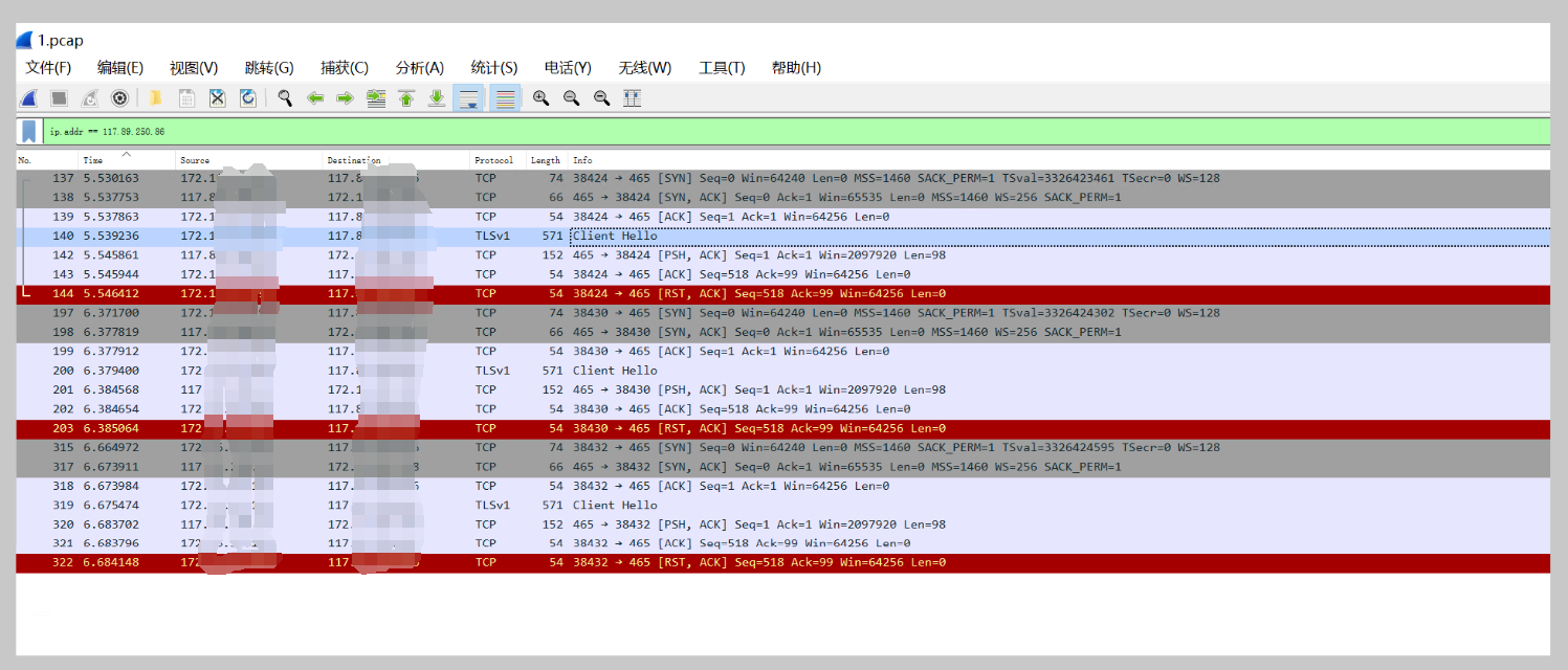

After setting these settings, it still doesn’t work. I found that the system prompted that the SSL version is incorrect. Is this because NextCloud used an SSL version that is not compatible with the email server when sending emails
172 is the NextCloud server, and 117 is the mail server.
