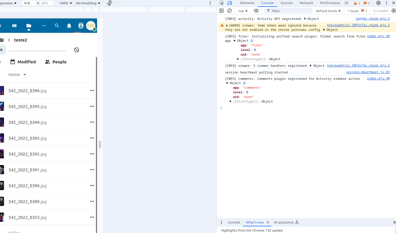

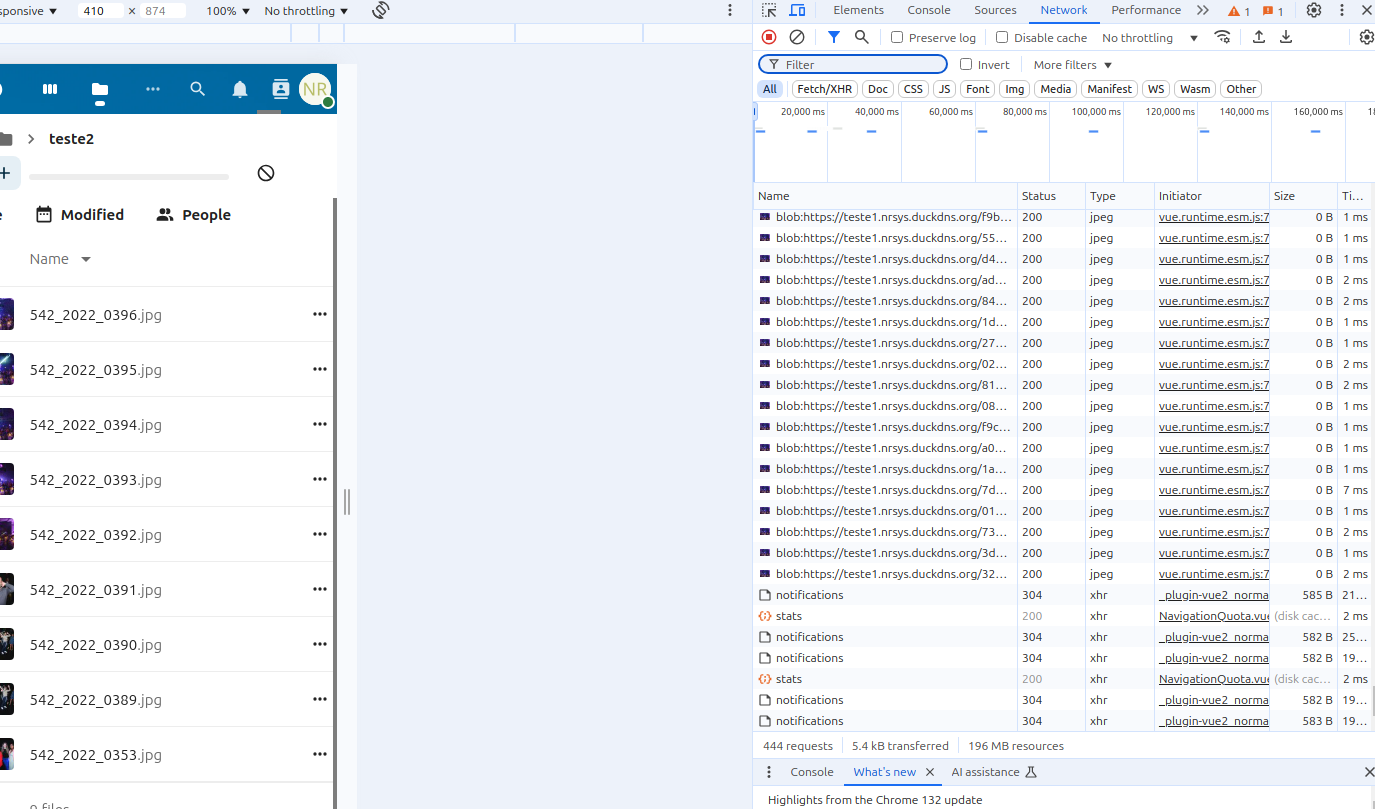

Problem 1:
  1. Upload x photos to Folder_A.
  2. Upload more photos to Folder_A with at least one photo that already exists in that folder
  3. After resolving the conflicts and press continue, the load bar shows up at zero and nothing happens. Zero photos are uploaded.
    Screenshot from 2025-01-28 22-22-36
