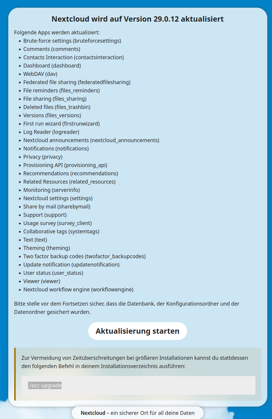

Upgrade '28.0.14.1', --> 29.0.12 - endless loop
Hi Zäma,
since long, long time, I have had no trouble with update in NC.
My Nextcloud is hosted by an IT provider.
Make upgrade 27 → 28 no problem. Next upgrade: 28.0.14.1, → 29.0.12
after this information:
Reparaturinformation: Change collation for nc_4371_login_ips_aggregated …
get a Information
“Es ist ein Fehler aufgetreten.”
and NC switched to Maintenance = "true"
After change the settings, Maintenance = "false"
Nextcloud is going to
again and again.
How do I get out of the loop. What is the reason? PHP - using 8.1.
Which config file I have to change or changing?
Need help please and any tipp.
Greetings

Are you doing the entire update/upgrade from the web UI? Have you attempted doing from the command-line to see if more information is shown?
use CLI - php occ upgrade
Finished code integrity check
Update successful
Turned off maintenance mode
Resetting log level
Don’t tell me why ist working and WEB upgrade not - it*s magics.
