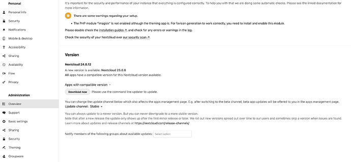

I would recommend you the “Upgrader” of the web interface.
In my case, the web updater does not show in the settings panel. Maybe I can install it somehow?
Then via CLI
https://docs.nextcloud.com/server/latest/admin_manual/maintenance/manual_upgrade.html
Looking at it right now :slight_smile: , an enormous thank you for the help.
