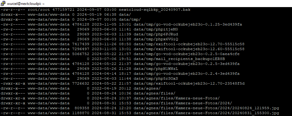

output of ncp.log (showing the restore output and ncp-report):
I am worried about following things:
  1. The error message, that shows up during nc-restore (shown in first screenshot too):
    ERROR 2013 (HY000) at line 256998: Lost connection to server during query
  2. The fact, that /var/www/nextcloud/data/agnes/files folder does exist - but does not have any files inside it although it’s part of the restore.tar.gz
output of first lines of my backup-file to be restored from (tar -tvf restore.tar.gz)

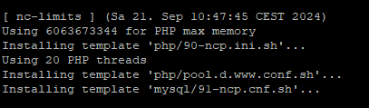

Digged into the issue with nc-restore:
That issue could be sorted out by manually starting nc-limits
grafik
That created/updated the mysql configuration
Installing template 'mysql/91-ncp.cnf.sh'.
These updated mysql configuration solved the error during nc-restore (restore of database).
Everything running fine afterwards:
