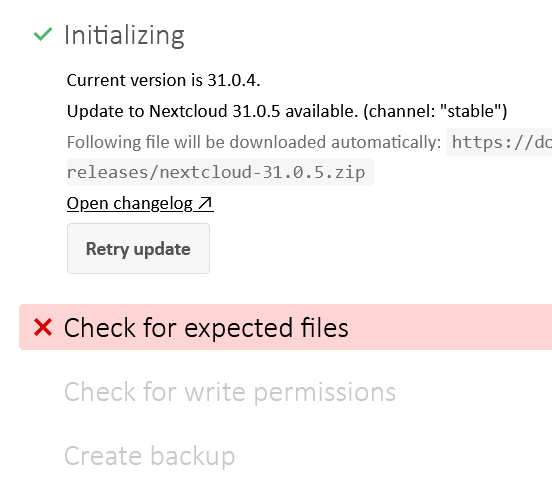

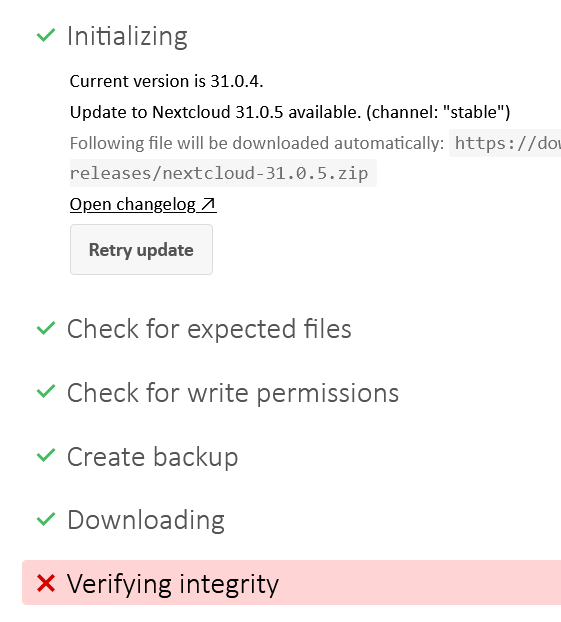

One instance stuck at “Verifying integrity” and one at “Check for expected files”
I have not changed anything in the configuration?

You may try using the command line updater which will display more details.
See Upgrade via built-in updater — Nextcloud latest Administration Manual latest documentation
In addition to what @awelzel said:
updater.log
will have more detailsThough there should also be more details visible in the web UI too. Not sure why you’re not seeing that. For example, underneath “Check for expected files” it should say Unknown files detected […] then have a bullet point list.
Yes, very useful as you can see:
Instance 1:
2025-05-17T07:00:05+0200 MmqvoMP49o [info] request to updater
2025-05-17T07:00:05+0200 MmqvoMP49o [info] currentStep()
2025-05-17T07:00:05+0200 MmqvoMP49o [info] Step 4 is in state "end".
2025-05-17T07:00:05+0200 MmqvoMP49o [info] POST request for step "5"
2025-05-17T07:00:05+0200 MmqvoMP49o [error] POST request failed with other exception
2025-05-17T07:00:05+0200 MmqvoMP49o [error] Exception: Exception
Instance 2:
2025-05-17T07:02:58+0200 dltIPOXWMo [info] request to updater
2025-05-17T07:02:58+0200 dltIPOXWMo [info] currentStep()
2025-05-17T07:02:58+0200 dltIPOXWMo [info] POST request for step "1"
2025-05-17T07:02:58+0200 dltIPOXWMo [error] POST request failed with other exception
2025-05-17T07:02:58+0200 dltIPOXWMo [error] Exception: Exception
Very strange the whole thing!
Yes you are right, but is was nothing to see there.
In any case, the manual updater on the console solved the problem. It worked straight away.
Lesson learned: Use the manual updater on the console and forget about the GUI.
