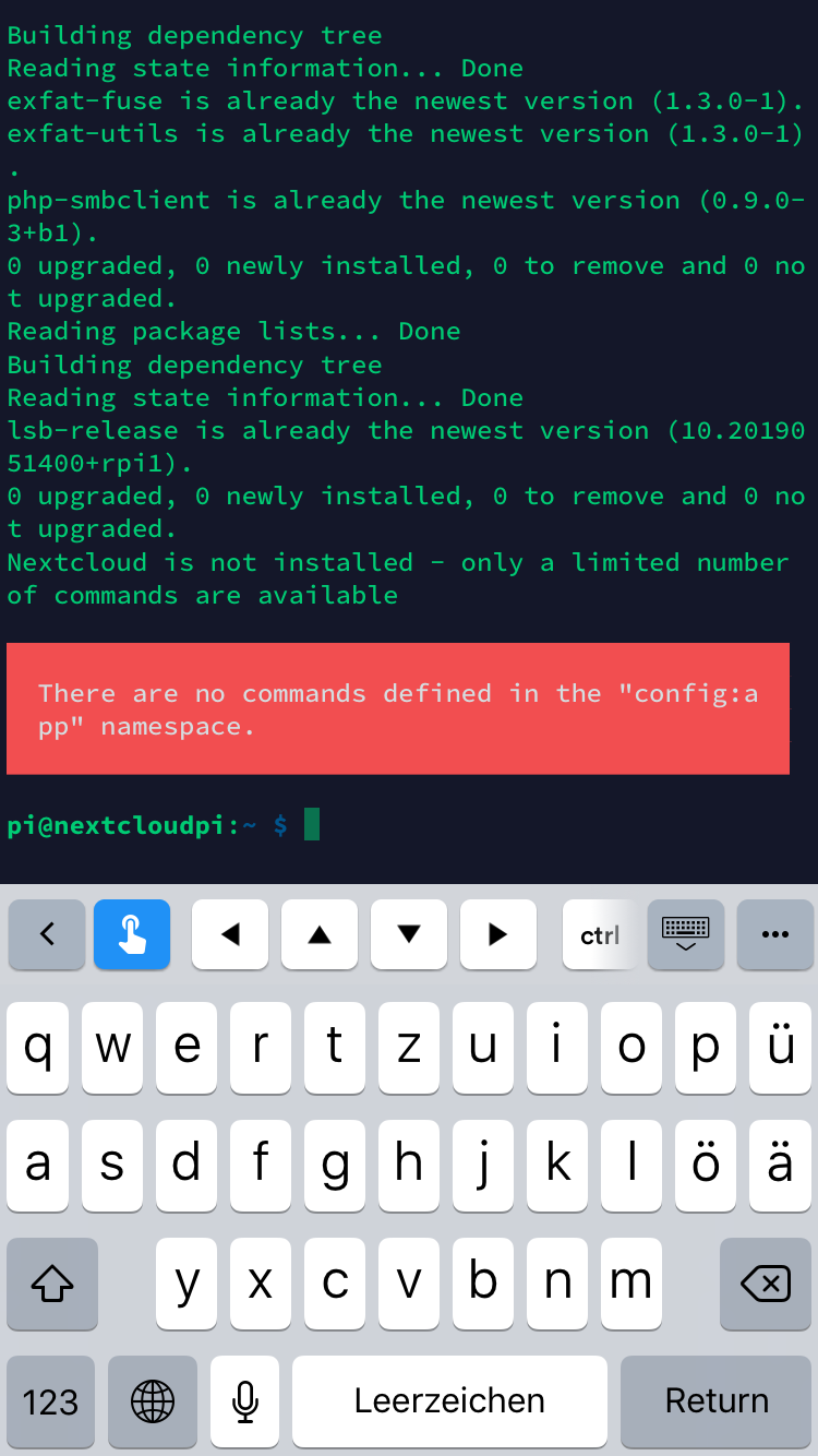

It’s Not possible to Update to 1.16.6 ,
Where it’s possible to look in log, so i Can post.
Im going Crazy

Checked documentation concerning staying up to date?
I have try this, it doesnt work
