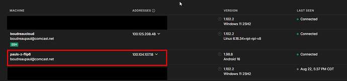

  1. local computers get a ‘This site can’t be reached’
  2. internet connected (Phone on cell network with wifi turned off) get an untusted Domain message
tailscale

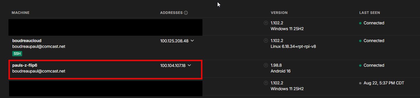

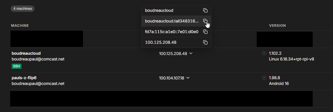

tailscale for the nextcloud server boudreaucloud.tail348316.ts.net
  1. tailscale running on phone 100.104.107.18
  2. tailscale running on cloudserver boudreaucloud.tail348316.ts.net or 100.125.208.48
  3. I’ve tried to add an entry in the config.php for 100.104.107.18 but this didnt do anything

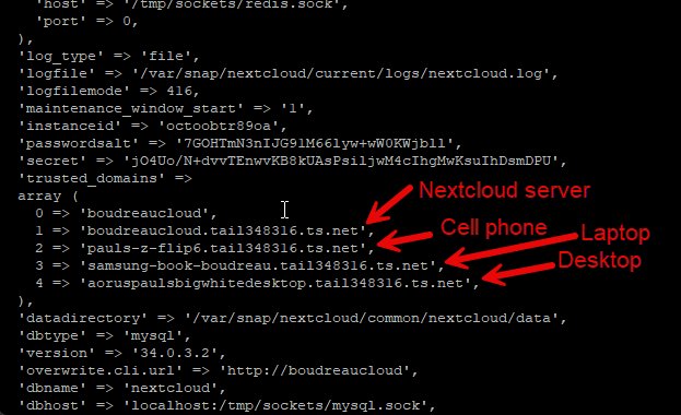

Hello @PaulBoudreau :waving_hand:
Please note that the “domain” part of this: boudreaucloud.tail348316.ts.net is actually ts.net - boudreaucloud is a sub-sub domain :smiley:
Try to add ts.net to your trusted domains list and see if that helps. The trusted domains list needs to be what is presented in the “host” header for the request, so I am not sure IPs will work :thinking:
Turns out replacing the IP address’ with domain names works for getting to the server over the internet.

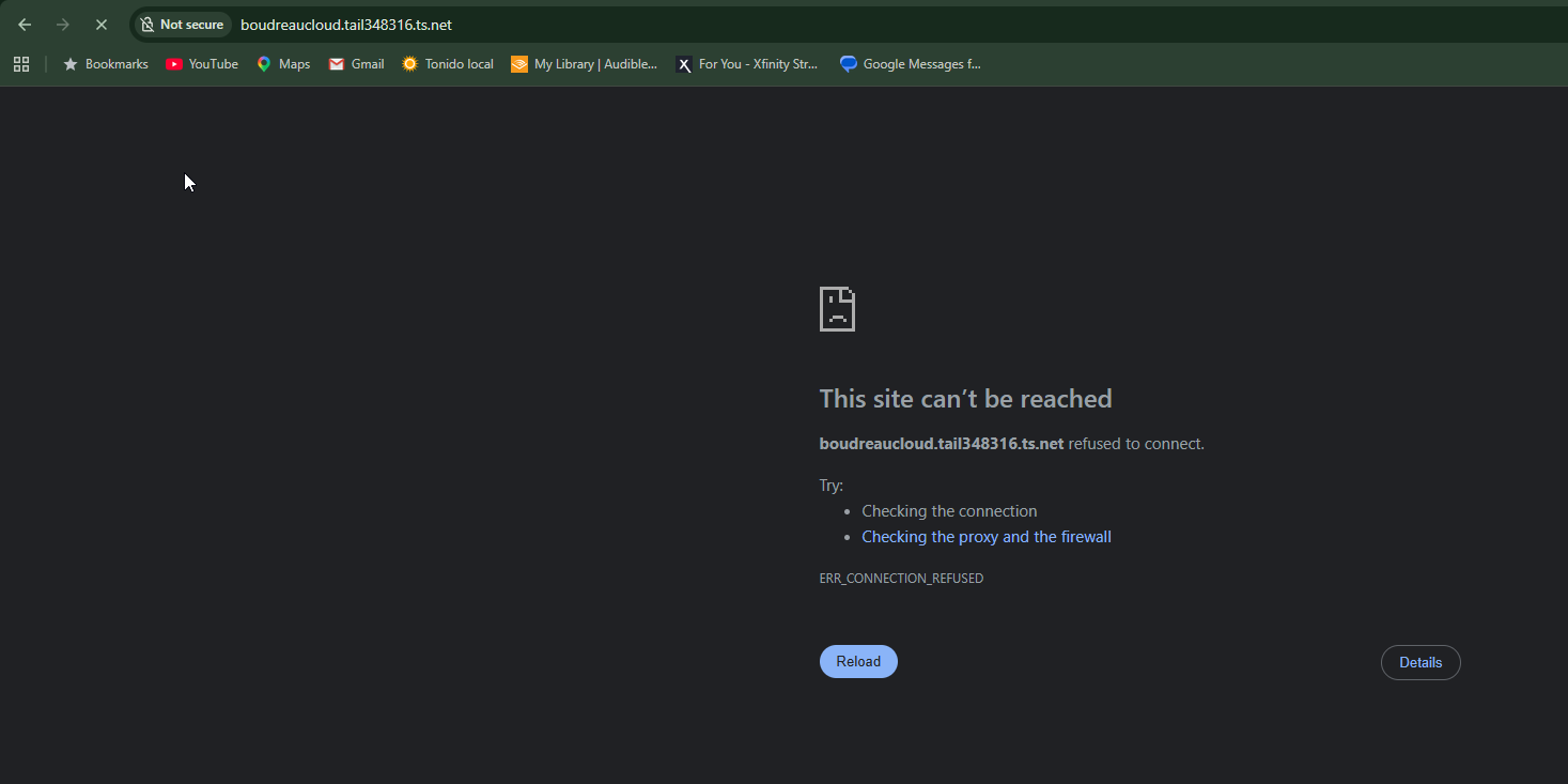

Locally accessing the server doesn’t seem to work though. My desktop, which is on the same local area network as the nextcloud server can’t access the server via boudreaucloud.tail348316.ts.net in a browser. It can ping the hostname. The results are still 'This site can’t be reached’ in the chrome browser. if i try to reach it via http://boudreaucloud/ on the local network it works.

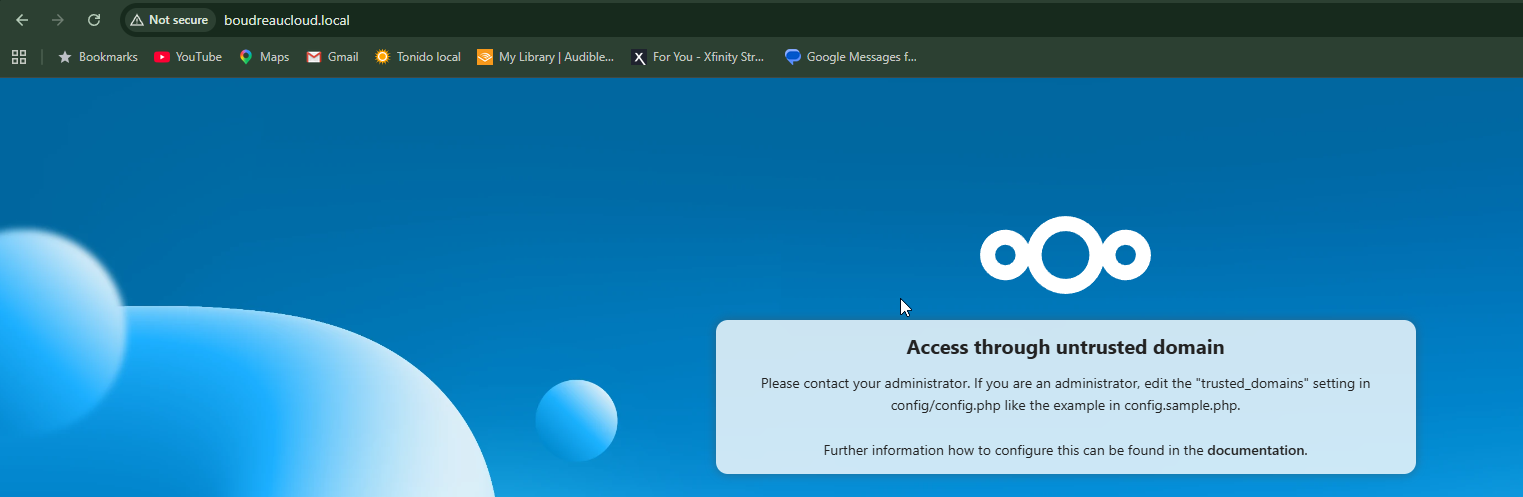

When i type ‘boudreaucloud.local’ on my desktop into the browser i get an ‘access through untrusted domain’ message again.

When i type ‘boudreaucloud.tail348316.ts.net’ on my desktop into the browser i get the ‘This site can’t be reached’

The .local option gives me the message ‘Access through untrusted domain’

If you add boudreaucloud.local to your trusted domains, that error will go away, hence why I suggested that as a workaround for you.
the “trusted_domains” array in your config essentially says to nextcloud:
If someone tries to access me using any of these domains in the host header, I can trust them
Since boudreaucloud.local is not in the list, nextcloud does its job, and blocks the access.
You do not need to add your other tailscale device DNS’s in that list, as you will not use those “domains” to access nextcloud.

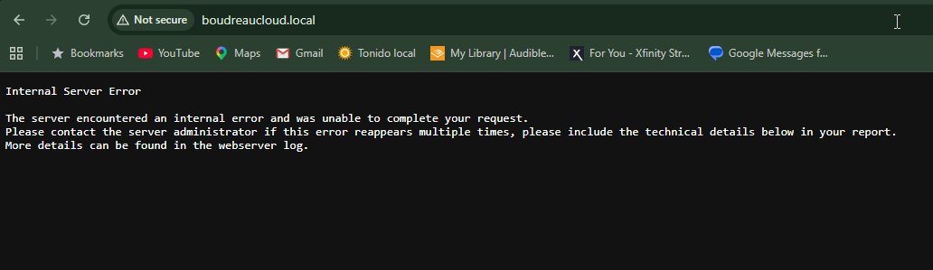

after i added boudreaucloud.local to the config.php i get this
aha, to figure out what that is due to, you will need to share some logs from your nextcloud instance. Internal server errors are usually logged there. Could you take a look?
i must have typed something wrong in the config.php the first time because i re added boudreaupaul.local and now that is working.
The only issue now is that browsing to ‘boudreaucloud. tail348316. ts. net’ gives a ‘This site cant be reached’

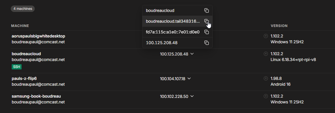

I tested this on my laptop also and it works with all 3 methods.
boudreaucloud
boudreaucloud.local
