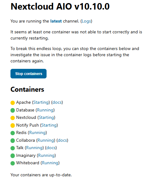

I’m installing Nextcloud AIO v10.10.0 using the spaceinvaderone container on Unraid and my AIO is stuck on:
“It seems at least one container was not able to start correctly and is currently restarting.”
I tried restarting the system, pruned everything for a clean install,

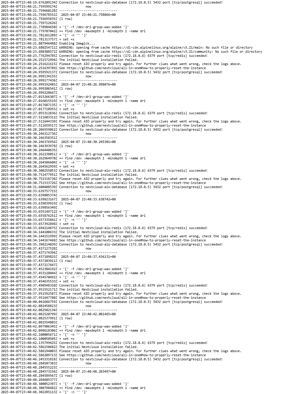

the logs from nextcloud is showing:

The logs you posted seem to be from the later container restarts. The one you need to find - which will container clues about the original cause - are the earlier entries (which don’t appear in your screenshot).
The full process involves more than just pruning. Did you see the documented process that is linked to in the error message here?
hey, thanks for replying. where might I find the earlier entries that have clues about the original cause?
Does the spot where you took the screenshot let you scroll upward?
no thats the highest it’ll let me go
