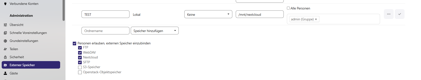

now enter the following command to enable external media in snap
sudo snap connect nextcloud:removable-media
now go to nextcloud GUI → files external → connect local device /mnt/nextcloud → be happy! :grinning_face:

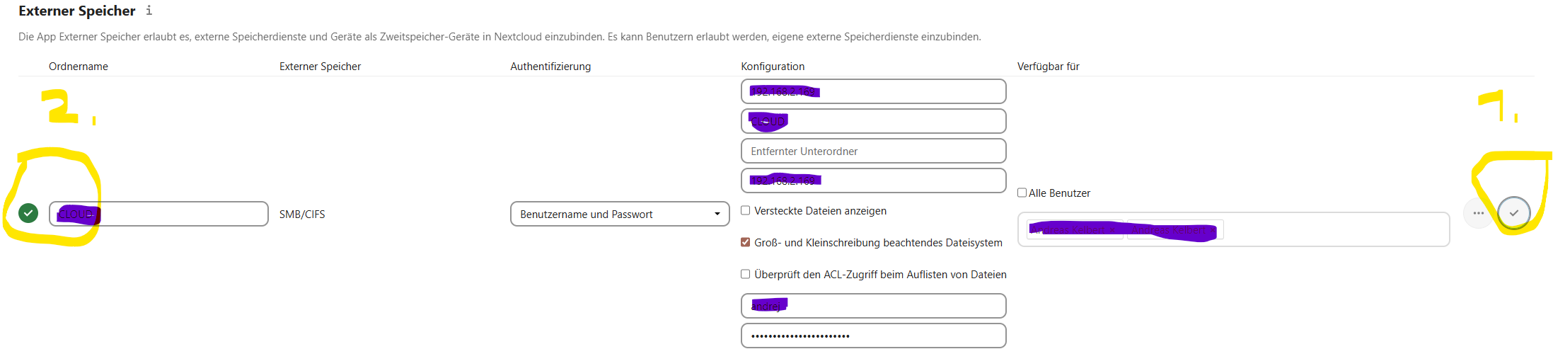

I am on external storage but I do not see connect… sorry

you must now add the storage to your Nextcloud instance.

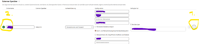

okay its connected but it says 0kb is this because there is nothing in there right now?
check the points: ext.drive is formated as ext4, mounted in your specify lokation
Right-click on the checkmark; a green circle should appear on the left—provided everything is correct. FYI in my case its an smb mount, in yours its local!
