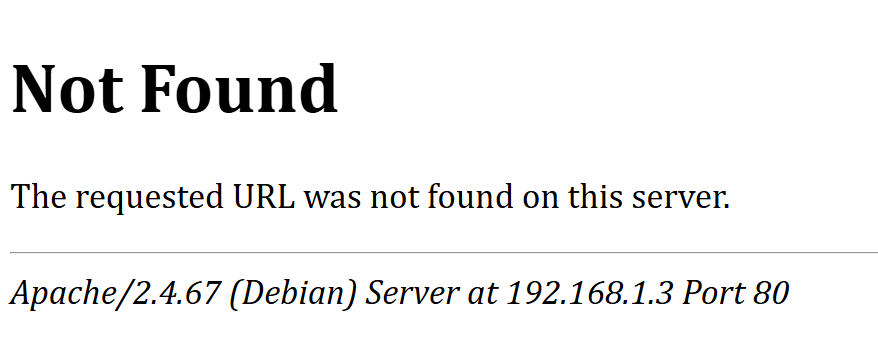

When I connect to the expected site (/Nextcloud which worked before), I got the following:
I have tried this both on my physical host and directly on the VM. In both cases Apache works, it’s just the /Nextcloud link that doesn’t.

In the new config you posted, you’re doing a VirtualHost-based install so there should be no sub-directory specified in the URL.
Are you saying just the base IP address? That just gives me the Apache home page.
James

Two things come to mind that you could try:
  1. Remove the backslash from <VirtualHost \*:80>.
  2. As far as I know, when using name-based virtual hosts, Apache looks for a matching ServerName or ServerAlias directive. If it doesn’t find a matching one, which is the case when you’re connecting via IP address, it falls back to the first virtual host in the configuration. On a default Debian installation, this is usually 000-default.conf.
    So make sure that the default virtual host is either disabled using
    a2dissite 000-default.conf
    or that you’re actually accessing the site via the hostname configured in ServerName rather than by IP address.
    Alternatively (although I’m not 100% sure whether this would actually work), you could try setting ServerName to the IP address or adding the IP address as a ServerAlias. Obviously, this would only work for a single virtual host unless your server has multiple IP addresses. So if you’re hosting multiple sites or services on that server and want to access them via IP address, you’d have to use subdirectories rather than separate virtual hosts.
It’s not the VM. Nextcloud runs fine in a VM.
From my own experience, accessing any web or Nextcloud servers via IP is PITA. Do you have a local DNS server? You should access your Nextcloud instance using a valid domain and yes that should match the name of the virtual host in Apache otherwise Apache will serve you the default home page.
When you access your server via its IP address then Apache will default to the um… default Apache home page. Apache expects a domain name that matches the name of the virtual host.
You may be able to work around this if you reconfigure Apache and disable the default home page or point it to your Nextcloud directory (not even sure if that’s possible) but it’s a dirty solution. Having a DNS and proper domain name is the right way.
This is required if you want to host multiple services on the same machine: mine is a NAS, a web server with two sites and a Nextcloud server, all accessed via different URLs. Even if you’re just testing NC in a VM it’s better to do this the right way so you get used to it.
If you don’t have a local DNS then you may try adding the Nextcloud domain and IP address to your hosts file.
