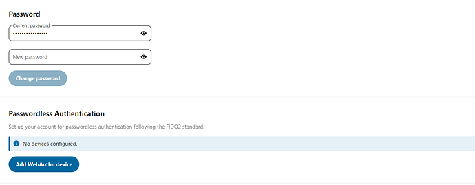

There is no check box.
Now I can’t even login. twofactor authentication is set to false in config.php
