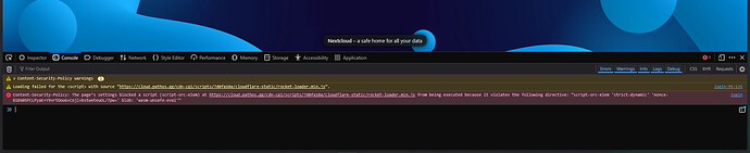

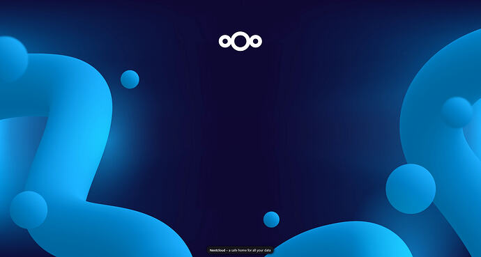

Hello. I am trying to install Nextcloud AIO on my machine, that is behind a traefik reverse proxy. Now, the domain I am using is on the HSTS preload list, and uses a CSP. However, for some reason, if I disable the CSP, the login page does not show up:

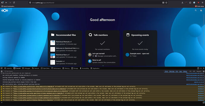

Upon enabling the CSP, this seemingly fixes itself, however, upon logging in with the initial admin password, there is absolutely no topbar. Sadly, there are also no errors in the console:

looking at your screenshots and CSP config, I think I can see what’s going on here — though I’d be curious if this matches what you’re seeing after testing.
In screenshot 2, the error is actually coming from Nextcloud’s own CSP, not your Traefik one. Nextcloud generates a strict nonce-based policy (script-src-elem 'strict-dynamic' 'nonce-...') and it’s blocking rocket_loader.min.js — a script injected by Cloudflare’s Rocket Loader feature. Since Rocket Loader is responsible for loading all other scripts on the page, blocking it causes the entire login UI to silently fail to initialize. No Rocket Loader → no scripts → blank page.
Your Traefik CSP uses script-src *, which allows Rocket Loader to run. But Rocket Loader works by intercepting all <script> tags and re-executing them asynchronously and out of order. Nextcloud’s frontend (including the topbar) is a Vue.js application that depends on a specific script initialization order. When Rocket Loader shuffles that order, the topbar components simply never initialize — and because nothing is actually blocked, no console errors appear.
So you’re not really switching between “broken” and “working” — you’re switching between two different failure modes caused by the same thing.
There’s also a secondary concern: your Traefik middleware is replacing Nextcloud’s nonce-based CSP entirely. That nonce mechanism is specifically designed to prevent XSS by only allowing scripts that Nextcloud itself generated. Replacing it with script-src * removes that protection.

Hey, thanks for the help.
Disabling rocket loader in CF fixed the issue.
