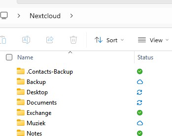

The sync status of some folders appears as ‘syncing’ (two circled arrows) whereas all files in that folders have status ‘synced’ (green arrow). I think, but am not entirely sure, that this happened since the update to the latest windows nextcloud desktop client 33.0.3. See below:
Status of folder ‘Desktop’ shows as ‘syncing’

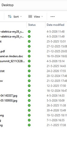

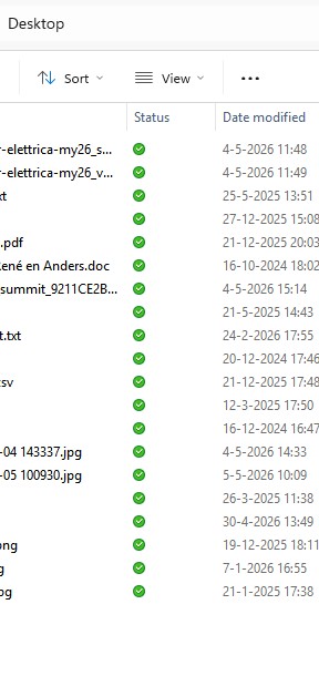

All files in folder Desktop are fully synced though:

Basically all suggestions I got from Chatgpt, without luck. Other folders work fine and the problem seems to persist on folders ‘Desktop’, ‘Photos’ and ‘Documents’. Only folder Desktop is a ‘standard’ windows folder though with a tab ‘Location’ in it’s properties. The others folders Photos and Documents also seem like the standard windows folders, but they are not. These two folders don’t have the property ‘Location’.

When I add a new folder, it’s symbol changes to the green tick. But the issue I am facing keeps persisting for folders
  • Desktop
  • Documents
  • Photos
I also tried renaming the folders and then create a new one with the previous name (so I change Photos to Photo and then create a new folder Photos but then the issue persists for folder Photos. It’s almost as if the 3 mentions folders have some specific properties that cause the behaviour I see.

There doesn’t seem to be a file called Desktop.ini in my nextcloud desktop folder by the way, but even so I have added it to the ignore list. As a result, it seems that the desktop client reviews all sync status symbols. But the issue with folder Desktop seems to remain because at the moment all files in the folder shows the green tick symbol, whereas the folder Desktop itself, shows as ‘being synced’.
