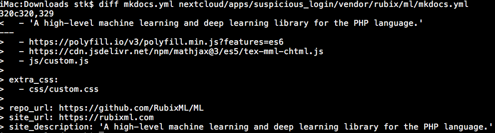

and diff generates this result:
diff Downloads/mkdocs.yml Downloads/nextcloud/apps/suspicious_login/vendor/rubix/ml/mkdocs.yml
320c320,329
< - ‘A high-level machine learning and deep learning library for the PHP language.’
extra_css:
  • css/custom.css
repo_url: GitHub - RubixML/ML: A high-level machine learning and deep learning library for the PHP language.
site_url: https://rubixml.com
site_description: ‘A high-level machine learning and deep learning library for the PHP language.’
can it help?
tanks a lot

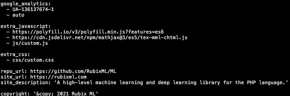

console output of diff
cat original mkdocs.yml
cat modified mkdocs.yml
