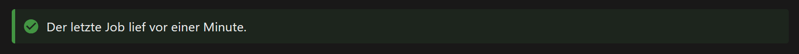

/settings/admin gives
grafik
(note: it’s been two days from shutting down all NC services on the old host and powering up everything on the new host now)
The cron is running fine and regularly (every 5 minutes), a manual run (sudo -u www-data php -f /var/www/nextcloud/cron.php) gives no errors.
Still, sudo -u www-data php /var/www/nextcloud/occ background-job:list lists many crons which did not run yet:

+++ sudo -u www-data php /var/www/nextcloud/occ background-job:list | grep -c 2025-04-11 gives currently 29 old cron jobs, now 4 hours after powering up Nextcloud. +++
Is this normal as the host ist just running for maybe one to two hours and I simply need to wait until the particular cron jobs reach their execution window?
If this is normal and if possible (for piece of mind) to get rid of the warning message I’d prefer to execute all cron jobs once completely.
some extensive jobs run only during the defined “maintenance window” which usually happens in the night. did you define the setting? did you wait at least one day to hit the maintenance window?
I was not aware of that „maintenance window“. Not sure where to define it. As described above NC is not yet running for more than 1 day so that MW is not yet passed. Seems to back my „normal, just sit and wait“ theory.
waiting is key. 30 hours later: done.
