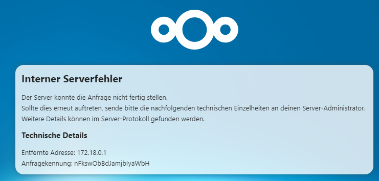

On editing the text of PageController.php I got some errors on my docker:
I get this error, if I remove the line:
use OCA\MYAPPNAME\AppInfo\Application;
In the tutorial, this line is missing.
The same happens with this code:
return new TemplateResponse(
            'helloworld',
            'index',
            ['myMessage' => $getParameter]
I think it is because my application’s name isn’t “helloworld”. If I replace it with
Application::APP_ID
it works.

That is where the logfile is made for. Then you do not have to gues but you will find exact line of code where it derails.
You should allways have one terminal window open with the log live, while you test:
tail -f /path/to/nextcloud.log | jq
