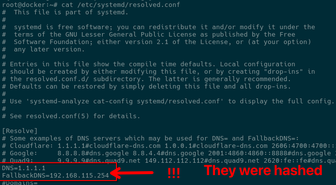

Well that did puzzle me, but I was not able to solve that DNS issue from the docker.service perspective. The /etc/docker/daemon.json file was already ‘provisioned’ with the recommended settings:
 { "dns" : [ "1.1.1.1" , "8.8.8.8" ] }
is ‘laying’ therein. :slight_smile: .
And there was a ‘quirky’ behavior, despite that setting. By that quirkiness, I mean: If I issued docker pull... (to get any of the required images that were spewing those error messages at the nextcloud-aio-mastercontainer docker logs), from the machine where the docker.service was running, I, most oddly, wouldn’t be greeted with any error. Meaning that the underlying OS – or just the docker service, one of them, that is… – was indeed coping well with DNS resolving. Notice that the /etc/docker/daemon.json file was already set with the same DNS’ that it has currently.
So I ‘guess’ that something was overriding that ‘local’ docker setting and using a more broad one. Which one?
Well I think it was the underlying OS (that was not handling out things very well).
Why?
Because they only began to ‘behave’ when I corrected them.
Look at the image and see for yourself:
After setting those, on the above image, things began to come together!

I think the main reason for this is that ‘subtle’ but ‘drastic’ change inside the systemd-resolved.service configuration!
Thank you for your hint! @MichaelFliegner ! I think it really is/was decisive!
And the solution (I guess) was pointed out by that ‘hiccup’ in the logs!
I am going to elect your hint as a sort of solution, due to its inheritant merit! And stress out that /etc/systemd/resolved.conf file was the cherry-on-top! :smiling_face:
