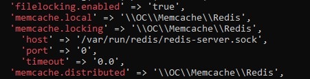

I already use redis for some other apps on my server, so:
  1. I know it works
  2. I don’t really want to edit the config of all my apps to use the socket Here is the redis part of my config:
  'redis' => [
     'host' => 'localhost',
     'port' => 6379,
//'memcache.local' => '\\OC\\Memcache\\APCu',
//'memcache.distributed' => '\\OC\\Memcache\\Redis',
'filelocking.enabled' => 'true',
As soon as I uncoment one of the two commented lines, nextcloud crashes without any log I tried and successed accessing redis throug redis-cli. Any idea?
  1. Use my config, wich is also on nexcloud documentation
  2. Install redis
  3. Cry
None, despite getting this message on the page:
Internal Server Error
The server encountered an internal error and was unable to complete your request.
Please contact the server administrator if this error reappears multiple times, please include the technical details below in your report.
More details can be found in the server log.
some 500 errors (one for the page, one for the favicon^^)
No error log but 500 errors in access.log of course

Here is how I proceed to configure Redis on Nextcloud:
Adding the user www-data to the redis group:
sudo usermod -a -G redis www-data
redis.conf file configuration:
sudo sed -i -e "s/^#* *port +*6379$/port 0/g" /etc/redis/redis.conf
sudo sed -i -e "s/^#* *unixsocket +*.*$/unixsocket \/var\/run\/redis\/redis-server.sock/g" /etc/redis/redis.conf
sudo sed -i -e "s/^#* *unixsocketperm+*.*$/unixsocketperm 770/g" /etc/redis/redis.conf
Verification :
sudo cat /etc/redis/redis.conf | egrep "^#* *port +|^#* *unixsocket +|^#* *unixsocketperm +"
Nextcloud-redis-conf
Restarting Redis:
sudo systemctl restart redis-server.service
File Locking and Memory Cache:
Enabling filelocking:
sudo -u www-data php /var/www/nextcloud/occ config:system:set filelocking.enabled --value="true"
Redis Configuration:
sudo -u www-data php /var/www/nextcloud/occ config:system:set redis host --value="/var/run/redis/redis-server.sock"
sudo -u www-data php /var/www/nextcloud/occ config:system:set redis port --value="0"
sudo -u www-data php /var/www/nextcloud/occ config:system:set redis timeout --value="0.0"
Configuring memcache.distributed (to be done after configuring Redis):
sudo -u www-data php /var/www/nextcloud/occ config:system:set memcache.distributed --value="\OC\Memcache\Redis"
Configuring memcache.local and memcache.locking:
sudo -u www-data php /var/www/nextcloud/occ config:system:set memcache.local --value="\OC\Memcache\Redis"
sudo -u www-data php /var/www/nextcloud/occ config:system:set memcache.locking --value="\OC\Memcache\Redis"
Verification :
sudo cat /var/www/nextcloud/config/config.php | \
	egrep "'filelocking\.enabled|'memcache\.local\
	|'memcache\.locking|'host|'port|'timeout|'memcache\.distributed"
Restart Apache:
sudo systemctl restart apache2.service
Config.php:
  'redis' =>
  array (
    'host' => '/var/run/redis/redis-server.sock',
    'port' => '0',
    'timeout' => '0.0',
As I said, the nextcloud log file is completely empty, and the nginx error file doesn’t show anything related to my problem (showing errors several hours before my problem, because I had done something wrong)
