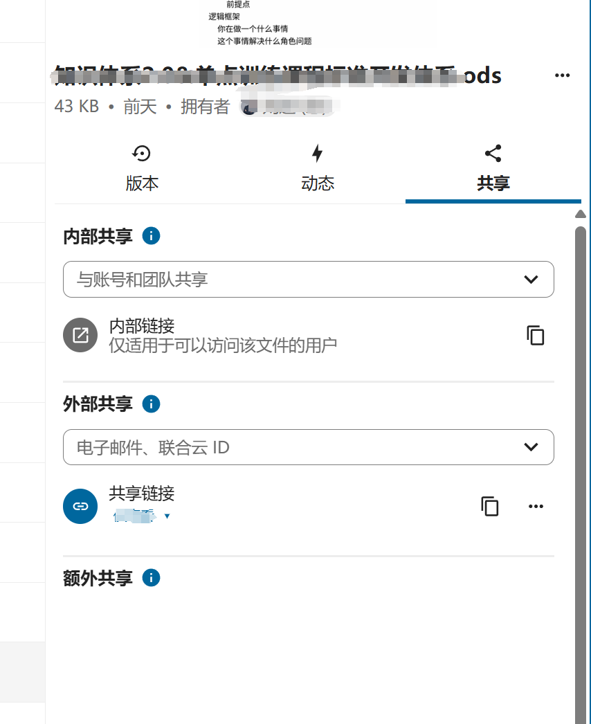

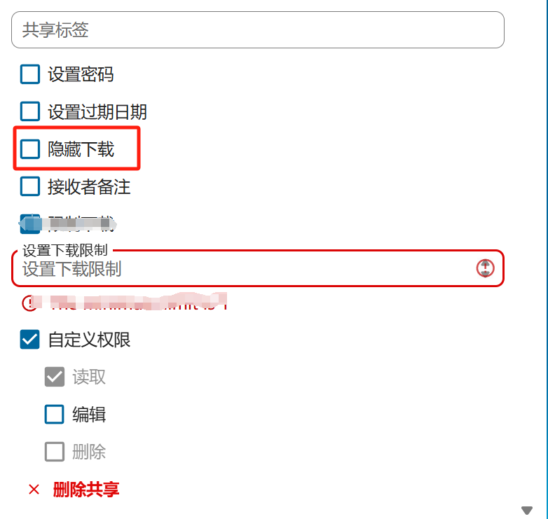

Sharing PDF files, setting them as custom and hiding downloads will result in the inability to view PDF files
Other file sharing formats are normal, but PDF files have a hidden nature and cannot be viewed when downloaded
What you see here is only for viewing and has become customized

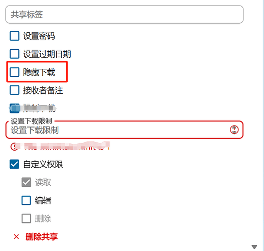

Then select this hidden download option
Afterwards, it will result in the inability to view PDF documents

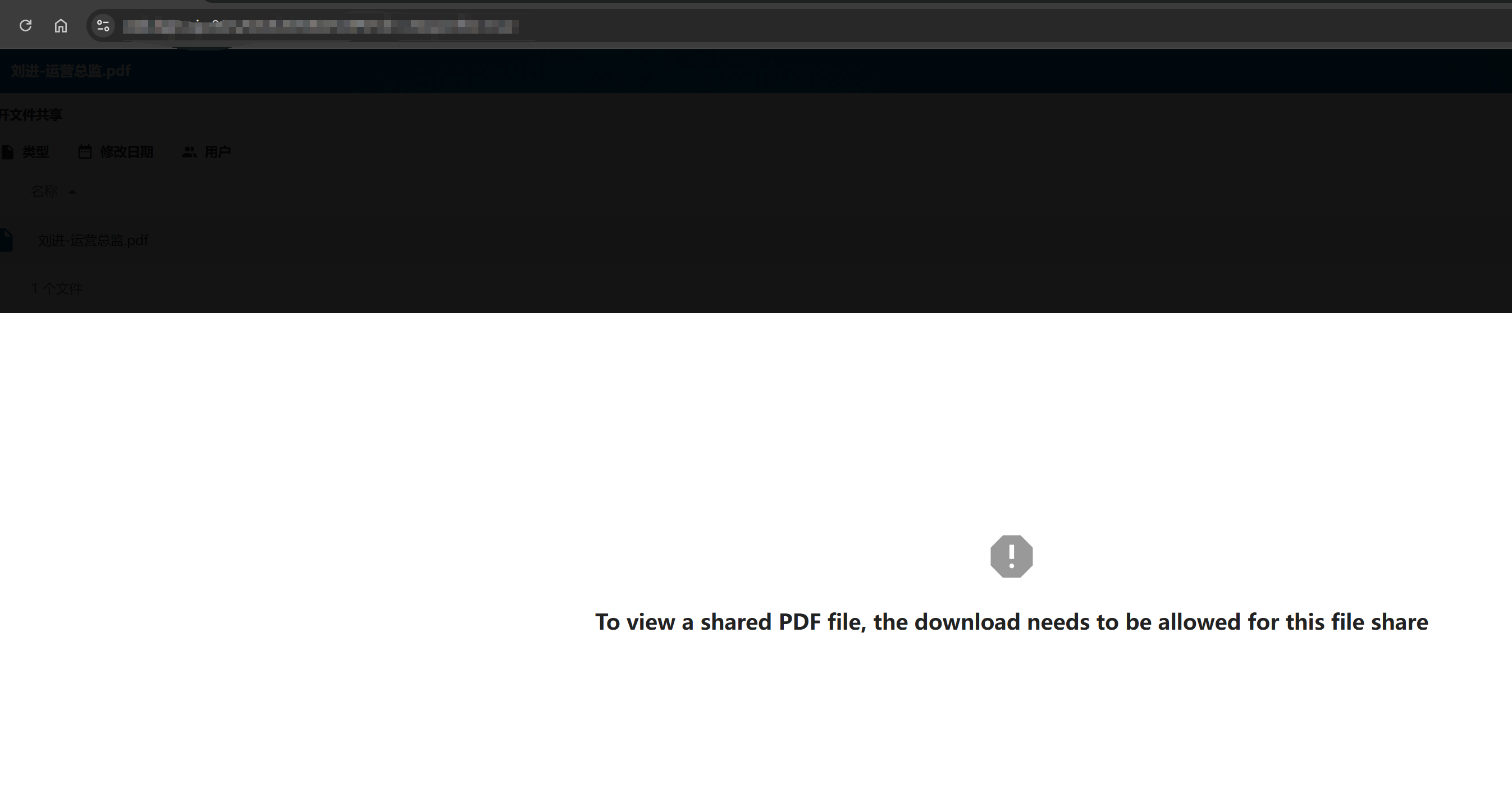

I can confirm that pdf files cannot be viewed anymore when “Hide download” is checked. Instead, the following message is shown: " To view a shared PDF file, the download needs to be allowed for this file share". Viewing pdf files while downloads are prevented used to be possible until very recently.

EDIT: After unchecking “Hide download”, saving, checking “Hide download”, and saving again, the pdf file seems to be viewable now.
