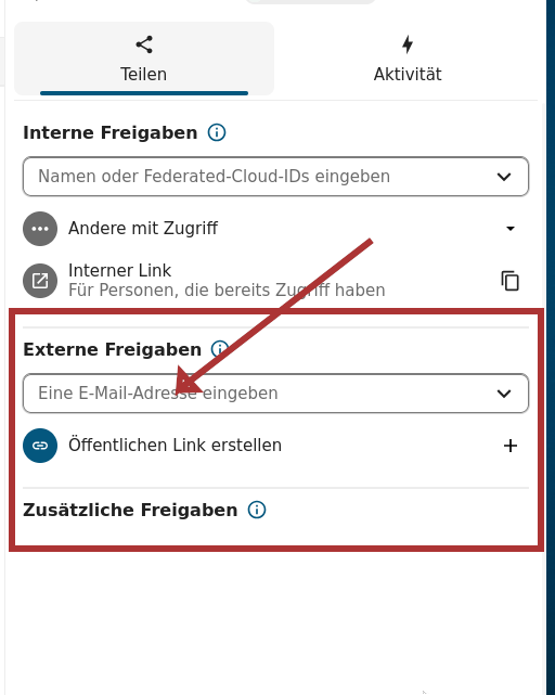

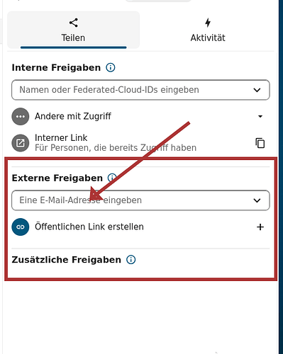

i am entered it here, above is the field for a federated ?

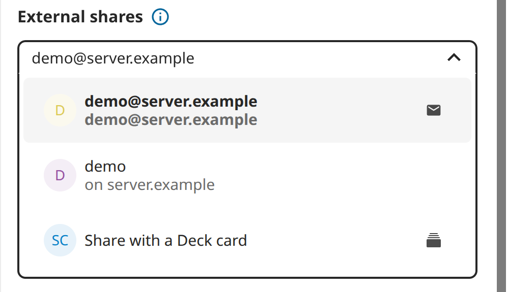

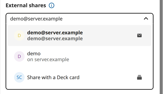

If you share by e-mail, Nextcloud will also ask you, if you want to send an e-mail with the link or if the e-mail address is a user on another server:
When you select “demo on server.example” and not “demo@server.example”, then Nextcloud will not send an e-mail but will try to contact the Nextcloud instance running on server.example to create a federated share.
So maybe you just selected the wrong option after typing the e-mail address? If you want to create a share link and get that send it via e-mail, you must always use the first version in the list with the e-mail address.
i get only “demo on server.example” presented. I get never “demo@server.example”. tried serveral mailadresses..
In this case I would ask the hoster who manages the Nextcloud server.
