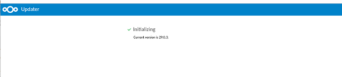

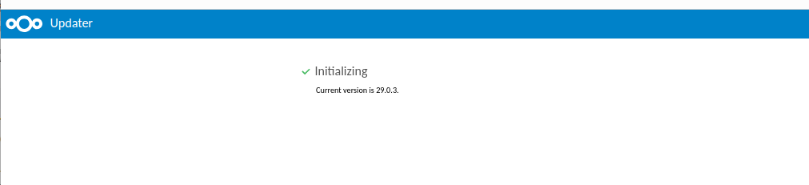

Sure? it now is stuck in:
curl -v https://download.nextcloud.com/server/releases/nextcloud-29.0.6.zip -o downloads/nextcloud-29.0.6.zip
% Total % Received % Xferd Average Speed Time Time Time Current
Dload Upload Total Spent Left Speed
0 0 0 0 0 0 0 0 --:–:-- --:–:-- --:–:-- 0* Host download.nextcloud.com:443 was resolved.
  • IPv6: 2a01:4f8:210:21c8::145
  • IPv4: 5.9.202.145
  • Trying [2a01:4f8:210:21c8::145]:443…
  • Trying 5.9.202.145:443…
    0 0 0 0 0 0 0 0 --:–:-- 0:02:14 --:–:-- 0* connect to 2a01:4f8:210:21c8::145 port 443 from 2a10:3781:xxx:xxx:xxx:4ff:feda:3dbb port 53072 failed: Verbinding is verlopen
  • connect to 5.9.202.145 port 443 from 192.168.xx.xx port 51736 failed: Verbinding is verlopen
  • Failed to connect to download.nextcloud.com port 443 after 134390 ms: Couldn’t connect to server
  • Closing connection
    curl: (28) Failed to connect to download.nextcloud.com port 443 after 134390 ms: Couldn’t connect to server
