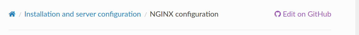

What would be the right place to suggest adding these options to the recommended nginx configuration in the Nextcloud documentation?
@mschilli I would use the ‘Edit on GitHub’ button of documentation.
