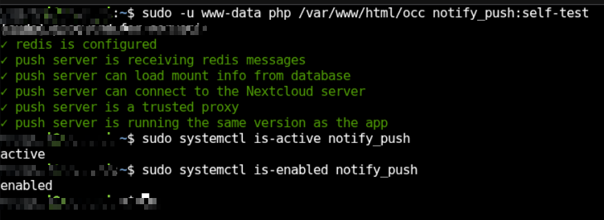

Hi Scubamuc,
Push serive is intalled and working

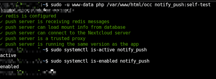

Hi Castillo92
yes
