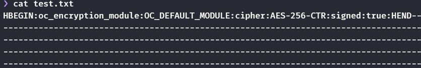

Server-side encryption is on and functioning but in the privacy module it says files are not protected with encryption.
Changing the setting to say that it’s full-disk encryption is a lie.
It needs to say that the files are encrypted

Hey @Eviepayne, this seems to be solved with the release of Nextcloud version 19.0.3 today. At least I can confirm the Privacy module now reports the correct information on my server:
Your files are encrypted with server-side-encryption.
