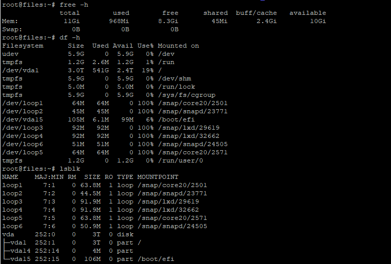

It looks like your not running any swap file.
This is the default setup for a virtual machine.
Try.
sudo swapoff -a
sudo dd if=/dev/zero of=/swapfile count=20 bs=1G
sudo mkswap /swapfile
sudo chmod 0600 /swapfile
sudo swapon /swapfile
swapon --show

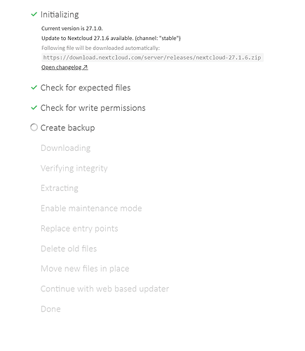

I have successfully upgraded Nextcloud to the latest stable version, 31.0.5, on a demo environment containing approximately 10 GB of data. The upgrade completed without any issues, and all files remain intact.
I have two questions before proceeding with the production environment upgrade (which holds around 2 TB of data):
  1. Do I need a separate backup?
    When upgrading a large production environment, is there any risk of data corruption or
    loss? Should I take a separate backup of the data before proceeding?
  2. What does “Delete old files” mean during the upgrade process?
    I came across a step labeled “Delete old files” during the upgrade. Could you please explain
    what this step does and whether it’s safe to proceed?
Your guidance on these points would be greatly appreciated.
Thanks & Regards,
Srinivasan
These questions are all addressed in the Maintenance chapter of the Admin Manual:
Thanks for the update. I will check that reply back to you.
The update itself touches the code and the database (normally not the data, not sure if there are exceptions). But linked to changes, some cleanup procedure, a client sync or … might get something wrong and delete or alter files.
For upgrades (to new version), I prefer to have a full snapshot of the whole system, so I can go back to exactly what is was before. I suppose you have some sort of backup anyway, question is how long does it take to restore something, and worst case how much is lost (changes since last backup).

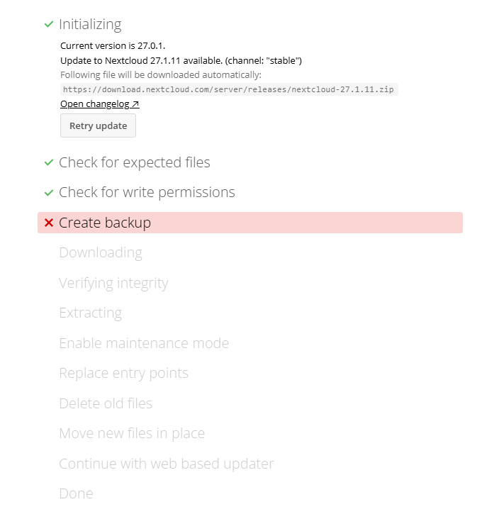

Similarly, when I tried to update the “Production Environment,” I got this error. Kindly help me to resolve this. But I have not received it like this when I did the same in the testing environment.
Anyone please answer for the above one
In the data/ folder, there should be a file updater.log, there should be more information.
Please use the command line updater and not the webupdater.
sudo -u www-data php /path/to/nextcloud/updater/updater.phar
documentation
With the command line updater you can disable backup. --no-backup
For normal Backup/Restore read Backup and Restore. Test your Backup/Restore on a test system. You don’t just need a backup in an emergency. You need a functioning backup.
