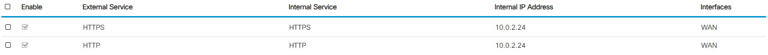

I registered a domain my_registered_domain.online that points to my home’s static IP.
My Cisco RV260 router manages a DMZ for Nexcloud server dedicated machine.
Unfortunately, my router binds WAN ports 80/443.
I installed Nextcloud AIO via SSH, indicating https://my_registered_domain.online as target domain.
Using port forwarding I can reach Nextcloud machine by remote:
  • SSH - port 22 (redirected from WAN port 10022)
  • AIO - port 8080 (redirected from WAN port 18080, https://my_registered_domain.online:18080)
About WAN port 443 (that I can use) I’ve tryed:
WAN/10443 → LAN/443 TCP&UDP
Just after AIO (complete and ok) installation the botton redirect to https://my_registered_domain.online, that’s not working as mentioned:
This site can’t be reached
my_registered_domain.online took too long to respond.
ERR_CONNECTION_TIMED_OUT
Typing https://my_registered_domain.online:10443 instead the browser replays:
This site can’t provide a secure connection
my_registered_domain.online sent an invalid response.
ERR_SSL_PROTOCOL_ERROR
Any suggestion?

I have no experience with Cisco routers. But I simply cannot imagine that it is not possible to forward ports 80 and 443 on a Cisco Small Business router. I mean, every cheap home router can do that. Unless, of course, the ISP blocks the ports or the ISP only offers IPv4 via CG-NAT.
Port forwarding:
Before you start with changes, do a backup of the recent configuration.
hello @Mornsgrans
I’ve tried both port forwarding and NAT, no way.
On Cisco forums they confirmed ports 80/443 are bound by the router itself.
The only solution they suggest is to set up Nextcloud to manage certificates through different ports, like 8443/8080.
So, do you think it’s possible?

that was exactly my first attempt, but no way. Unfortunately the router prioritize its own rules before processing port forwarding, NAT, etc. as Cisco’s people confirm.
This is why I hope to find a solution for Nextcloud on different ports.
And what happens, if you disable these rules?
totally indifferent whether they are enabled or not: ERR_CONNECTION_TIMED_OUT
