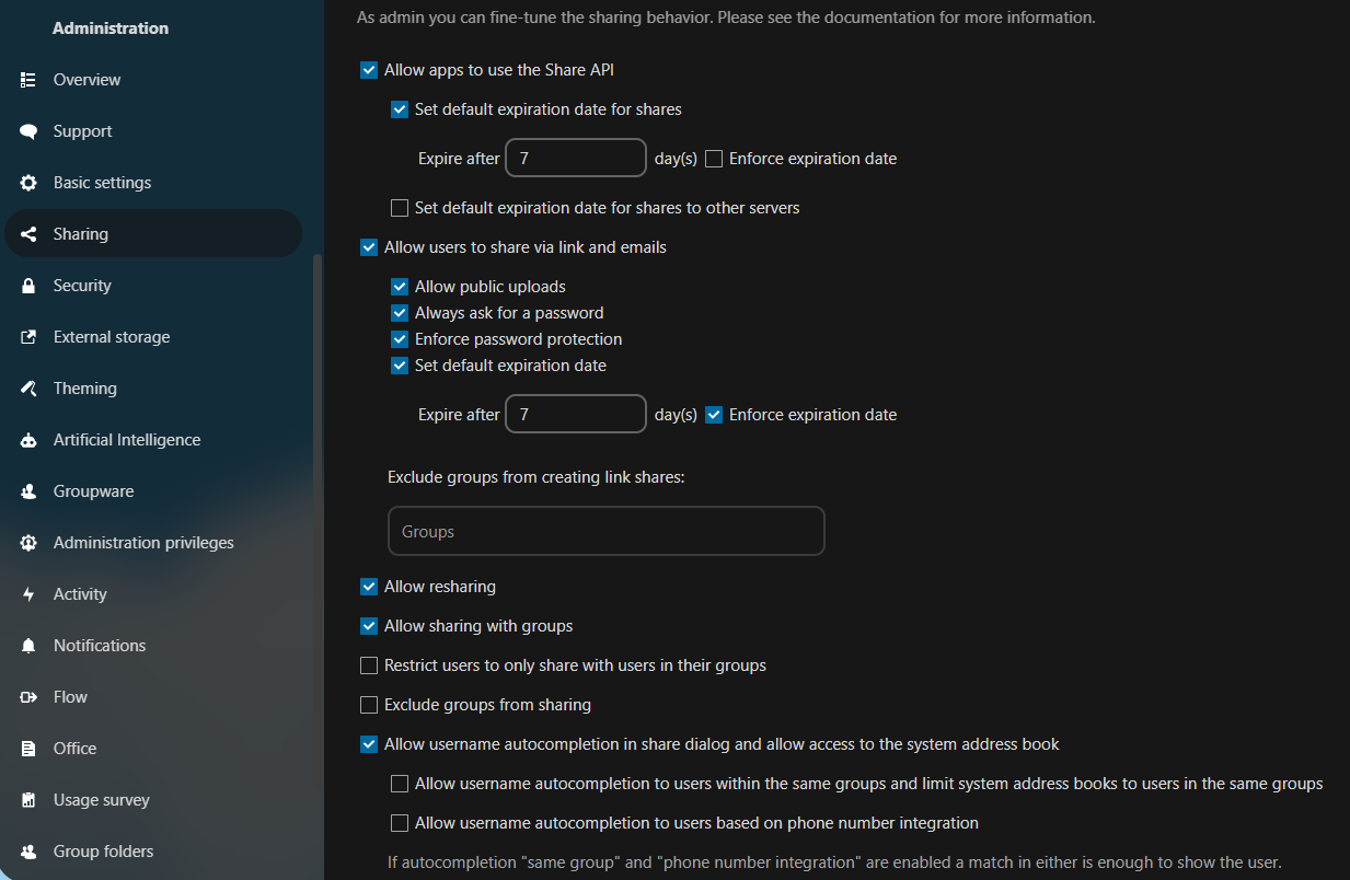

I don’t have a management under administrator settings, but in sharing this is checked. Is this what you are meaning? It says to allow user to share via link and emails.

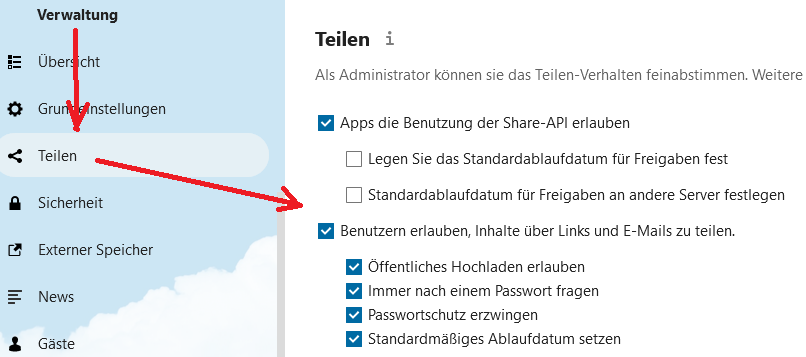

I meant the general settings, not the personal ones. And further below these settings it can be set which are the default share functions available to users (I’m using the German desktop so that it might be possible that I haven’t catched the exact ttranslation):
grafik
That is where I am at under the administration settings. Your left side menu and options under settings looks different than mine though.
