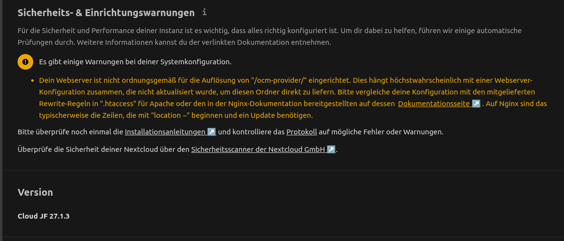

Hi there,
i am currently running 27.1.2 on Debian / nginx. Now i just realized, that i get a warning message prior to updating that ocm-provider is not correctly set up.
It forwards me to the Documentation here to fix the problem:
https://docs.nextcloud.com/server/27/admin_manual/installation/nginx.html
but there is nothing about ocm-provider.
where do i find more information for that problem?
Thanks a lot!

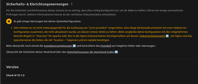

hannesf
November 15, 2023, 12:23pm
3
hmm, the problem seems to still exist (also rebooted the machine…)
this is my nextcloud.conf:

from what i can tell it should have all the ocs provider settings.hmm maybe someone can help?
Thanks a lot!!
