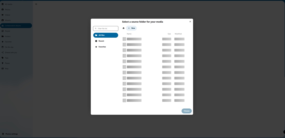

Fresh install Nextcloud Hub 7 (28.0.4) noting works. Installed with Softaculous installer.
Cant upload, or crate folders, Photos nor videos.
Failed to create /photos/admin/albums/ELITE.
Does not see the folders probably.
