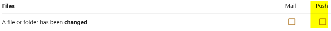

I would start with the first one - review the web UI while changing some files - if the created/modified date changes first step works (you can use occ as well - there is a commend like files:info or similar). Once this works continue with push - review you notification settings at {cloud uri}/settings/user/notifications and check Push for “A file or folder has been modified
then you should start receiving “notifications” (look at bell icon top right in the web UI) once the file is modified, by default it takes some time. Adding notify_push to the system makes this notifications arrive faster/instant on each client mobile/desktop/web.. push notifications to mobile is another story (but works well by default).
