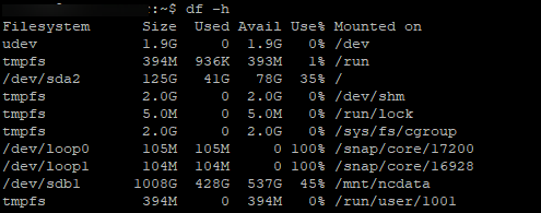

I can access via SSH and it’s hosted on my own infra. I did no changes and suddently the access was gone. Tere is still space left
what else do you need from me?
From the df -h output, it’s clear you have SSH access, and the /dev/sdb1 disk is mounted as /mnt/ncdata — which likely holds your Nextcloud data.
You’re also running Snap packages, so it’s quite possible that Nextcloud was installed via Snap.
