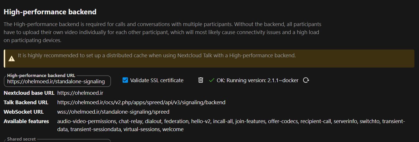

  • High Performance Backend (HPB) Signaling Server
  • Coturn TURN/STUN Server
  • Apache Reverse Proxy
  • SSL certificates configured and working

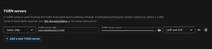

TURN Configuration (sensitive values removed):
'turn_servers' => [
    'url' => 'turn:ohelmoed.ir:3478',
    'protocols' => ['udp', 'tcp']

Calls are established successfully and both participants can join the room. HPB appears to register users correctly and call sessions are created. However, no audio or video is transmitted between participants.

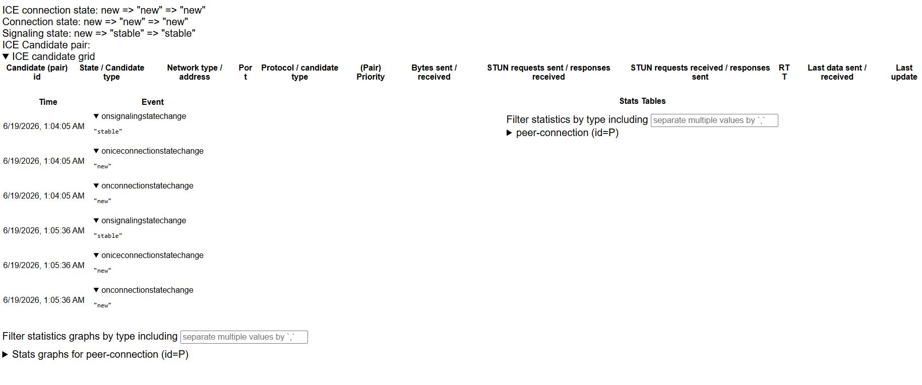

Browser Diagnostics
  • Browser console output
  • chrome://webrtc-internals output
  • Screenshots of ICE/TURN/WebRTC errors (if needed)

from your description it looks like coturn is not working. did you add port forwarding? system architecture is shown here Nextcloud Talk High Performance Backend (HPB) - Multi-Domain Setup Guide - #3 by wwe
Review
Check your browser about:webrtc (firefox) if there are srflx and relay “candidates” - if not TURN doesn’t work and connection will not work behind firewalls
Thank you for your reply.
The server is running on a public VPS. I will verify the TURN configuration, firewall rules, and candidate types reported by WebRTC.
I will also collect information from chrome://webrtc-internals and check whether relay candidates are present.
I will post the results shortly.
