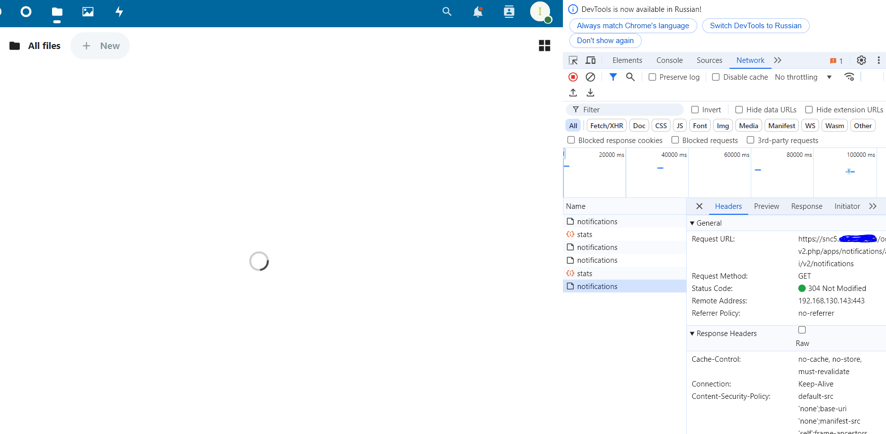

when using access by https I see that:

Perhaps should you track network errors on debug panel on your browser ( F12 button) .
You should be able what it is waiting for …
while the directory structure is loading, only notifications are visible in debug
server trying to show 237K dir

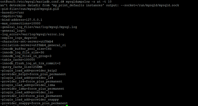

May be I can get more speed of querries select?
Anybody have any ideas how can speed up querries to mariadb(innodb)?

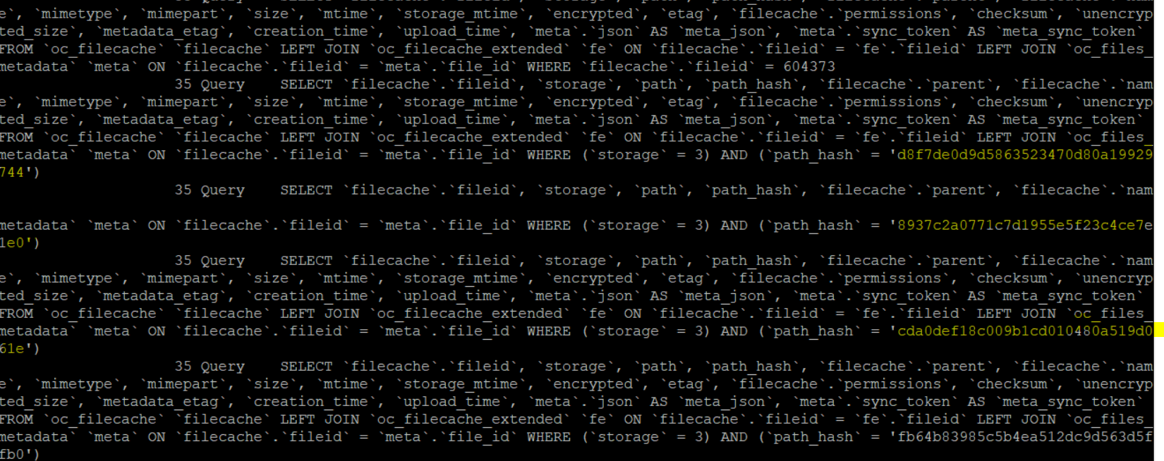

this is the slow-log in time when i opening root catalog by https
