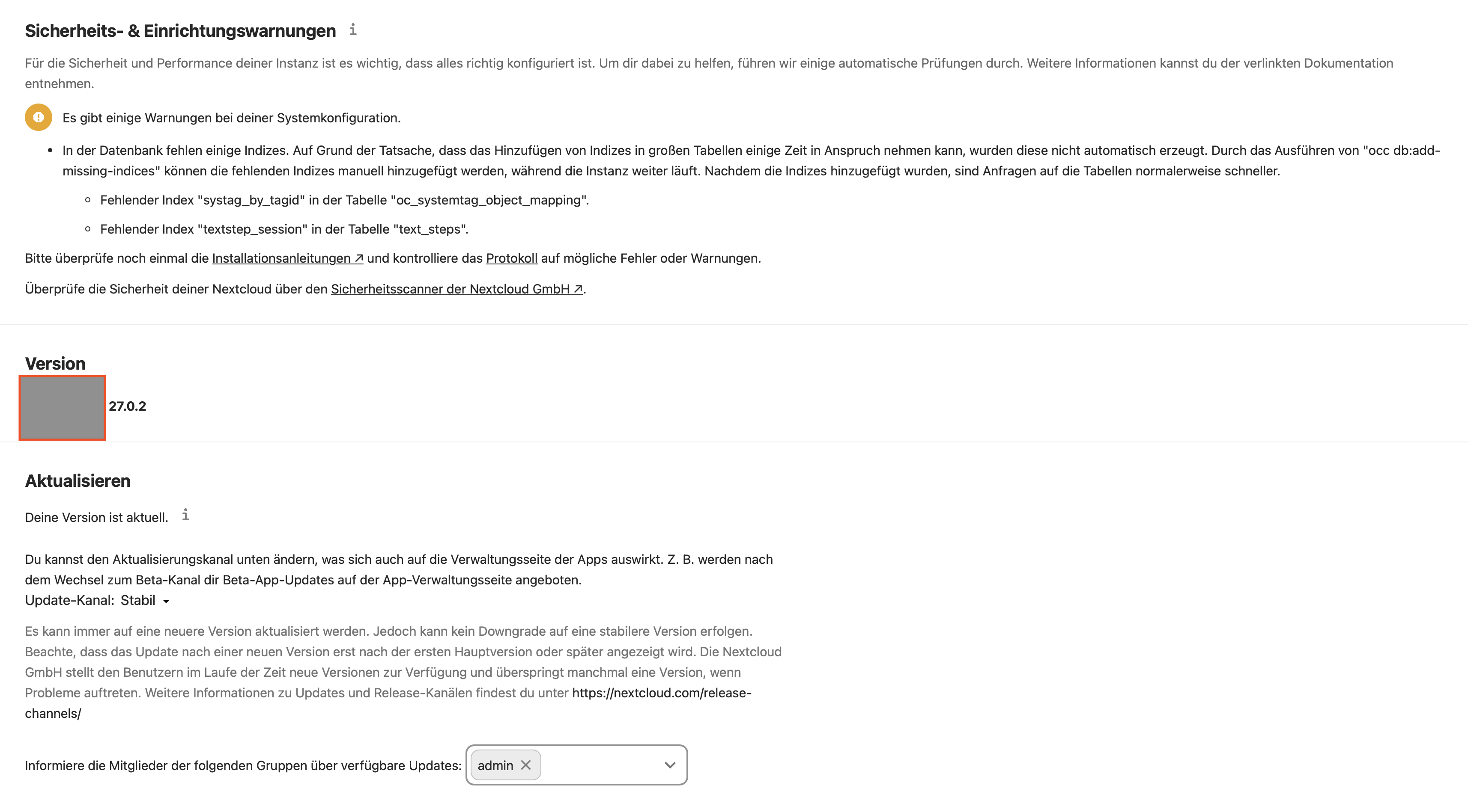

After Upgrading via Web Updater from 27.0.1 to 27.0.2 i had some missing db indexes.
I was trying to fix this via sudo -u www-data ./occ db:add-missing-indices and got
Nextcloud or one of the apps require upgrade - only a limited number of commands are available
You may use your browser or the occ upgrade command to do the upgrade
So i was curious, a just updated to the latest version but got this message, so i did sudo -u www-data ./occ config:system:get version and got
25.0.8.2
Also my config.php stats version 25.0.8.2, but the Web UI and also security scan gives me 27.0.2.1
So i guess the db already is on 27.0.2.1 but the files in wwwroot are still 25.0.8.2?

After leaving maintenance mode i see this on the web page
So i do update here, got this
But on shell e.g. sudo -u www-data ./occ status i still have
  - installed: true
  - version: 25.0.8.2
  - versionstring: 25.0.8
  - edition:
  - maintenance: false
  - needsDbUpgrade: true
  - productname: Nextcloud
  - extendedSupport: false
Anything more i can do?
I am running out of ideas…

Your posted Nextcloud configuration:
Your posted reverse proxy configuration:
What is 172.16.0.6?
172.16.0.80 != 172.16.0.6
There is no way these are the same installation (unless you’re doing some really weird NAT in between or there’s yet another proxy in between these or something… I guess).
What happens if you visit http://172.16.0.6 from your local network in your browser?
For that matter, what happens if you visit http://172.16.0.80?
My expectation of the results:
http://172.16.0.6 is your NC27 instance
http://172.16.0.80 is your NC25 instance
I too am looking forward to getting to the bottom of this mystery - no matter what it turns out to be! :slight_smile:
Dear jtr,
thank you, but you are totally wrong.
It is easy to understand, let me explain.
172.16.0.6 = IP of nextcloud host
172.16.0.80 IP of nginx reverse Proxy
These are to different machines, and it is not really complex to understand.
And, again, believe me, i know that i have only 1 nextcloud instance in my network.
Dear ernolf,
thank you for your input.
grep -Ern --only-matching “(27.0.2.1|25.0.8.2)” /var/www/nextcloud is giving me
/var/www/nextcloud/config/config.php:12:25.0.8.2
grep -rnF --only-matching “27.0.2.1” /home/data was a little time to wait an gave out
/home/data/nextcloud.log:49897:27.0.2.1

I get that, but is it possible you have two installations of NC on the 172.16.0.6 server? Maybe one that isn’t installed in /var/www/nextcloud/? Maybe in /var/www or /var/www/html or something like that? Since your data directory is located outside your webroot it’s even possible to have two active Nextcloud installations pointed at the same data (in theory).
Your proxy configuration is obviously working, since you’re able to access your v27 NC service.
I’m still curious about the output of visiting the different URLs. Or, better yet, try:
I’m perfectly willing to be wrong. I’m just interested in getting to the bottom of this. :slight_smile:
Dear jtr,
AHHHHHH, i’m SO sorry!!!
By no reason, (i think im getting old) i missed that i have a old copy on /var/www/nextlcoud
After your POST i just checked the apache2 conf, seeing just that i’m stupid and apache is pointing to /var/www/html/netcloud. And this is the right directory. i cloud do db:add-missing-indices, everything is fine now.
So conclusion for me, i really need to double check what i’m doing. And second, thanks for all the great support i got here. All of you are really great!
