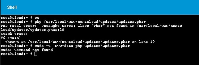

Do you use sudo -u www-data php updater/updater.phar? Post messages.
documentation
I was try use

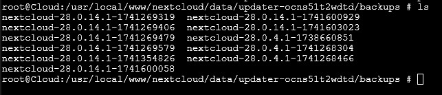

Here is it updater.log

2025-02-04T09:20:51+0000 FDVnAgi2Na [info] createBackup()
2025-02-04T09:20:51+0000 FDVnAgi2Na [info] backup folder location: /usr/local/www/nextcloud/data/updater-ocns51t2wdtd/backups/nextcloud-28.0.4.1-1738660851/

2025-03-06T13:41:06+0000 ba4OL8y1Cg [info] POST request for step "3"
2025-03-06T13:41:06+0000 ba4OL8y1Cg [info] startStep("3")
2025-03-06T13:41:06+0000 ba4OL8y1Cg [info] createBackup()
2025-03-06T13:41:06+0000 ba4OL8y1Cg [info] backup folder location: /usr/local/www/nextcloud/data/updater-ocns51t2wdtd/backups/nextcloud-28.0.4.1-1741268466/
2025-03-06T13:45:56+0000 K4CUfJ2RMw [info] end of createBackup()
2025-03-06T13:45:56+0000 ba4OL8y1Cg [info] end of createBackup()
2025-03-06T13:45:56+0000 K4CUfJ2RMw [info] endStep("3")
2025-03-06T13:45:56+0000 ba4OL8y1Cg [info] endStep("3")

Can you install packages on TrueNAS? If yes install the package “php-phar”. You need it for the command line version with updater.phar. Also you must use the correct user, your webserver/database/Nextcloud user e.g. www-data:
From root:
sudo -u www-data /usr/local/www/nextcloud/updater/updater.phar
Post command and errors.
I find issue, I make update pkg install php82-phar and then I make manual upgrade and I have next issue:

[ ] Extracting ...PHP Warning:  require(/usr/local/www/nextcloud/updater/../version.php): Failed to open stream: No such file or directory in phar:///usr/local/www/nextcloud/updater/updater.phar/lib/Updater.php on line 694
PHP Fatal error:  Uncaught Error: Failed opening required '/usr/local/www/nextcloud/updater/../version.php' (include_path='.:/usr/local/share/pear') in phar:///usr/local/www/nextcloud/updater/updater.phar/lib/Updater.php:694
Stack trace:
#0 phar:///usr/local/www/nextcloud/updater/updater.phar/lib/Updater.php(732): NC\Updater\Updater->getVersionByVersionFile()
#1 phar:///usr/local/www/nextcloud/updater/updater.phar/lib/UpdateCommand.php(384): NC\Updater\Updater->extractDownload()
#2 phar:///usr/local/www/nextcloud/updater/updater.phar/lib/UpdateCommand.php(237): NC\Updater\UpdateCommand->executeStep()
#3 phar:///usr/local/www/nextcloud/updater/updater.phar/vendor/symfony/console/Command/Command.php(255): NC\Updater\UpdateCommand->execute()
#4 phar:///usr/local/www/nextcloud/updater/updater.phar/vendor/symfony/console/Application.php(1021): Symfony\Component\Console\Command\Command->run()
#5 phar:///usr/local/www/nextcloud/updater/updater.phar/vendor/symfony/console/Application.php(275): Symfony\Component\Console\Application->doRunCommand()
#6 phar:///usr/local/www/nextcloud/updater/updater.phar/vendor/symfony/console/Application.php(149): Symfony\Component\Console\Application->doRun()
#7 phar:///usr/local/www/nextcloud/updater/updater.phar/updater.php(10): Symfony\Component\Console\Application->run()
#8 /usr/local/www/nextcloud/updater/updater.phar(14): require('...')
#9 {main}
  thrown in phar:///usr/local/www/nextcloud/updater/updater.phar/lib/Updater.php on line 694
root@Cloud:/usr/local/www/nextcloud/updater #

Sorry i deleted all my automated backups. Look at /usr/local/www/nextcloud/data/updater-****/backups/nextcloud-version-number/
It’s look that I have
I find version.php in one of this subfolders, that I copy to root vesion.php?
Ok i updated a beta Nextcloud and i get the file version.php in my backups directory.
Check in your posted backups-directory:
find . -name version.php
Yes I do that. And I found the file.
Ok. Maybe copy it to /usr/local/www/nextcloud. But i think it is maybe not the correct version.
